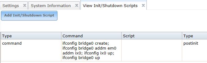

jgreco , Thanks again! I got it to work (with just a couple of revisions).
It survived few test restarts / shutdowns - comes back to life as expected. I'm planning to upgrade to 9.3 tonight, will see how it will go.
If someone wants to try it, below is the postinit script to use.
In my case em0 - adapter connected to the switch / rest of the network. ix0 - adapter connected directly to the workstation. Just substitute your interface names and it will work.

You can probably redo that somewhat more clearly as:
ifconfig ix0 up; ifconfig bridge0 create; ifconfig bridge0 addm em0 addm ix0 up
I should never offer advice while on a mobile device. I always forget something. ;-) My concern was whether or not the "command" option would let you run several commands separated by semicolons, since this is ordering-dependent. The command I just gave is probably the cleanest, shortest way. But I applaud the effort you took to make this work, I very much appreciate anyone willing to put forth effort rather than just hope for an answer on a silver platter.
