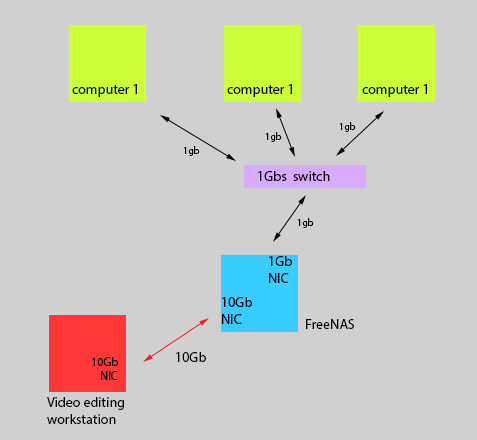

Basically I can't spend money on 10gb switch because I only need 1 of the machines connected by 10Gb.
Below is a quick doodle to explain what I want to achieve. My main workstation is used for 3D, video editing, after effects, nuke, etc. It would really benefit from 10 Gb connection. Other few computers are used for basic graphic design and 1GBs is enough.
Is it possible to setup freenas to act like a switch? Sorry I have zero FreeBSD experience, would really appreciate is someone can point me at right direction.
Short answer: No.
Long answer: Connect the workstation to the switch and to the server. Configure the 10GbE connection manually on both ends.

Thanks. So there is no way to setup a bridge on the freenas server?

Is there any way to set up the freenas server as a "switch"?
rogerh
Apr 18, 2014
1,111
You don't need a switch if the two 10GB NICs are directly connected to each other. Don't even need crossover cables nowadays.

What you want to do is possible by hacking the OS. As this isn't something I recommend, support, or endorse, I will NOT explain how to do it. Been around the racetrack with questions like this, and hacking the OS always leads to even more problems later. For you, the answer is simple.. "no". It's a question that, if asked, the obvious answer is "no".
rogerh
Apr 18, 2014
1,111
If all he wants to do is make a 10Gb connection between one workstation and the FreeNAS server I don't see why he needs FreeNAS to do any routing.
That's the point, he doesn't. It's plug, set IPs and play.

And, for reassurance, the workstation can be connected to the 1Gb subnet at the same time via a different NIC and provided they are different subnets this will not prevent a direct connection via 10Gb.
I think he's wanting the video editing workstation to be available to the internet. That's the deal breaker. OTOH if he's using the video editing workstation for video editing and has no intention of accessing anything on any other machines, it will just work. But I'm pretty sure he's wanting the former.

If he has another NIC on the workstation that's no problem.
pirateghost
Unintelligible Geek
Feb 29, 2012
4,219
There is no issue as long as there is a regular NIC in the workstation as well.
Leave the regular NIC alone, on the regular subnet.
Just like everyone else has been saying you simply give the 10gb NIC an IP/subnet differently from your regular network and connect them.
This is a simple config actually. The second NIC will not have a gateway tied to it.

Yes, my workstation also has a regular 1Gb NIC. So for now I will use 10G to the server, and 1G to the switch to connect to the internet / other computers. With different subnets of course.

Thanks everyone, I got it to work - everything is perfect.
One more question though.
Just like you suggested, my setup is:
192.168.1.13 - 1Gb adapter connected to a 1Gb switch, ip is given by DHCP
192.168.0.100 - 10Gb - I manually set this ip.
My workstation connected to the switch by 1Gb nic, and directly to freenas by 10gb. CIRF shares, I'm using windows 7.
Everything works like it should - I'm getting gigabit speeds then I connect to freenas by typing //192.168.1.13, and if I go with //192.168.0.100 speeds are 5x higher. So it's good.
Question is - I just realized if I type //freenas it will automatically choose 10GB ip. Is that normal? Can I map network drives using //freenas, or should I still force //192.168.0.100?
