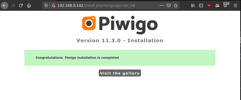

Hi all,
Today I had a moment and started to write my Piwigo plugin for TrueNAS based on Unofficial iocage Plugin manual
I have new file piwigo.json and post_install.sh, but before I can finish this, please may I ask you to take a look and check if I'm doing all in proper way?

3. Is there any other way to modify/edit files I'm trying to replace in post_install.sh with "FETCH -O" ?
4. I'm having a problem with setting up mysql database, with user and password.
AfroUSA
Mar 27, 2017
28
Got to the moment when all was working perfectly, but than after another test, I got stuck on POST_INSTALL.SH. Some kind of permission problem? Basically its not working after setting chmod to +x or 0755. PIWIGO.JSON working perfectly, installing iocage, all needed packages, but than:

This is iocage /root/ folder where after setting up new iocage I have post_install.sh
root@Piwigo-1:~ # ls -l
total 23
-rw-r--r--  2 root  wheel   957 Jul  5  2019 .cshrc
-rw-r--r--  1 root  wheel   149 Jul  5  2019 .k5login
-rw-r--r--  1 root  wheel   395 Jul  5  2019 .login
-rw-r--r--  2 root  wheel   474 Jul  5  2019 .profile
-rwxr-xr-x  1 root  wheel  2391 Feb 18 22:40 post_install.sh
Running post_install.sh from SSH terminal I have this:
root@Piwigo-1:~ # sh post_install.sh
nginx_enable:  -> YES
mysql_enable:  -> YES
php_fpm_enable:  -> YES
: Operation not supportedreate /dev/null
cp: /usr/local/etc/mysql/my-small.cnf: No such file or directory
: Not Founds://raw.githubusercontent.com/AfroUSApl/piwigo/master/nginx.conf
: Not Founds://raw.githubusercontent.com/AfroUSApl/piwigo/master/php.ini
: Not Founds://raw.githubusercontent.com/AfroUSApl/piwigo/master/nginx/conf.d/piwigo.example.com.conf
: Not Founds://raw.githubusercontent.com/AfroUSApl/piwigo/master/php-fpm.d/piwigo.example.com.conf
: Not Founds://raw.githubusercontent.com/AfroUSApl/piwigo/master/php-fpm.d/www.conf
cat: /root/dbpassword: No such file or directory
post_install.sh: 56: Syntax error: end of file unexpected (expecting "then")

I did manage to update my files following your advice. I'm using 12.2-RELEASE, additional files in /overlay folder as there is a lot of code to replace, hence easy to swap file.
Process passed without errors. One thing needs to be changed while installing Piwigo on first setup page, is Host: from localhost to 127.0.0.1.
Plugin is ready for testing :)

Woohoo, it worked!
The scripts look good. I also had to change the host to 127.0.0.1, so maybe add a line for Host: 127.0.0.1 to the post-installation notes /root/PLUGIN_INFO so all those initial settings are in one place.
I would suggest to create a "12.2-RELEASE" branch; this is just to remove one of the warnings during installation. It tries to match to the FreeBSD version of FreeNAS/TrueNAS, and reverts to the "master" branch otherwise.
