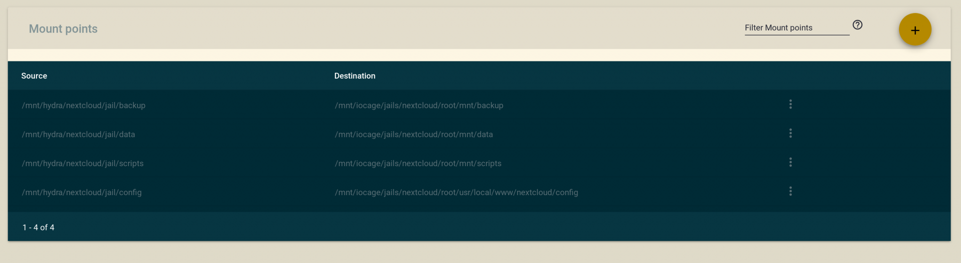

I also decided to add some mountpoints for the jail:
This lets me keep data and config outside of the jail. The backup folder stores current mysql database backups.
