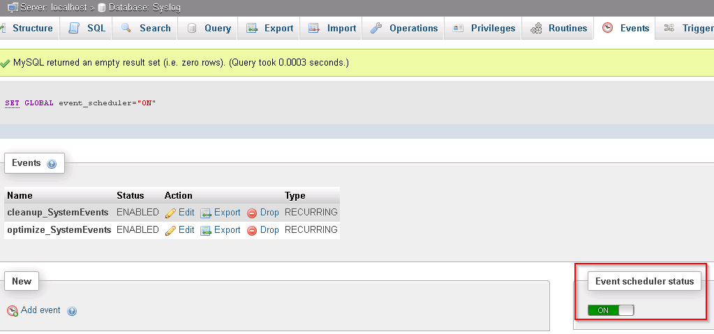

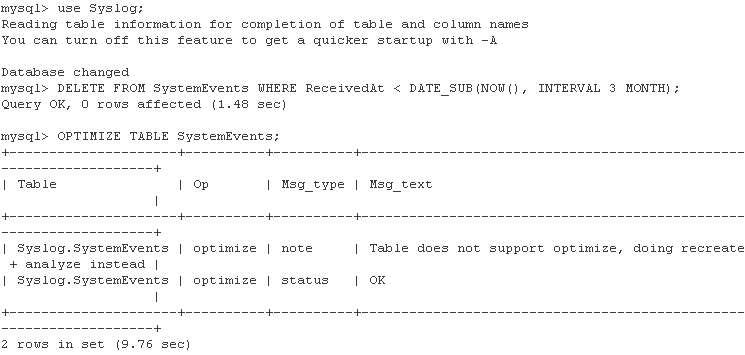

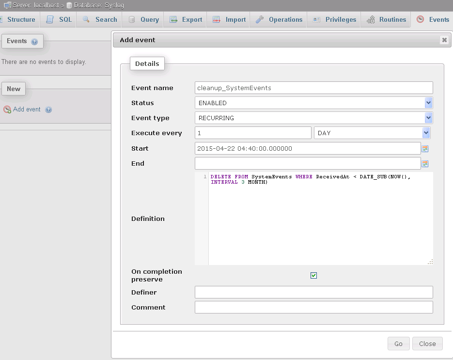

6. Automatic log cleanup
  • Either use code, or use the phpMyAdmin gui
    CREATE EVENT `cleanup_SystemEvents` ON SCHEDULE EVERY 1 DAY STARTS '2015-04-22 04:40:00.000000' ON COMPLETION PRESERVE ENABLE DO DELETE FROM SystemEvents WHERE ReceivedAt < DATE_SUB(NOW(), INTERVAL 3 MONTH)
    CREATE EVENT `optimize_SystemEvents` ON SCHEDULE EVERY 1 DAY STARTS '2015-04-22 04:55:00.000000' ON COMPLETION PRESERVE ENABLE DO OPTIMIZE TABLE SystemEvents;
  • Enable the mysql event scheduler. I used the phpMyAdmin gui. I Don't have the command for that.
  • You might check if these lines work outside of the event schedule

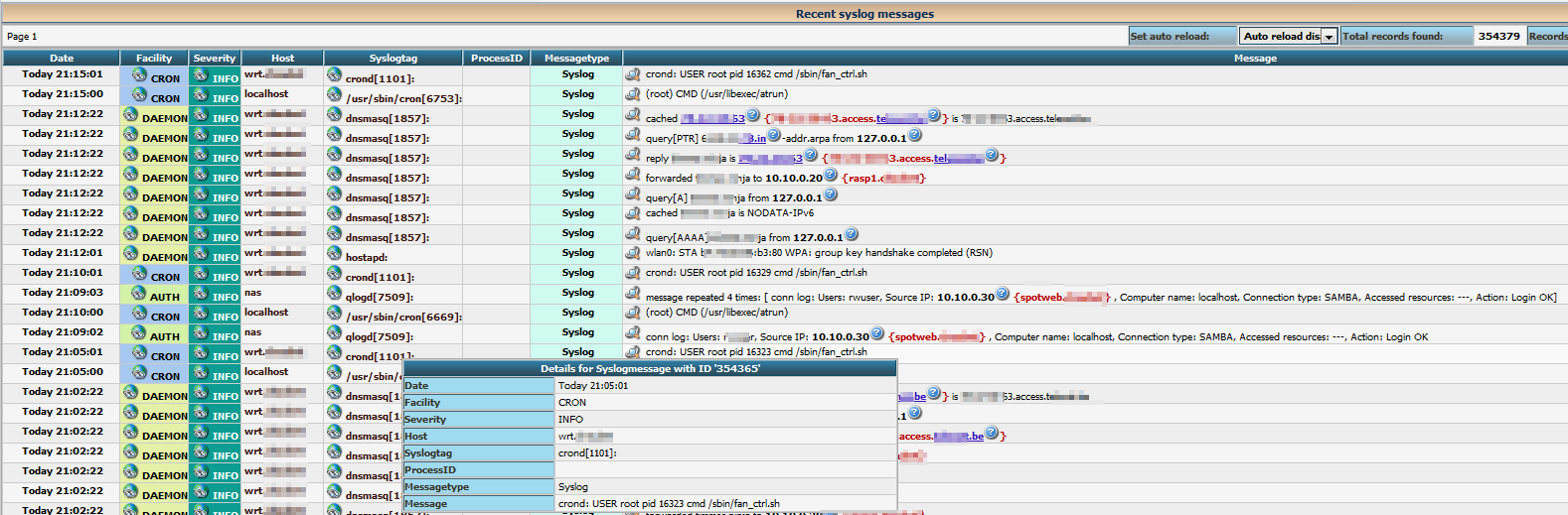

7. Result (sorry about the blurfest)
In the Syslog database, the logs will take up approximately 260 bytes per entry.
When logging everything from all servers (so not just the criticals & warnings), this will generate a serious datastream. Keep an eye out. I'm at 100 MB atm and am not noticing any delays so far.

1 more remark: set a decay on that database to only keep the last x days, weeks or month OR only log the bare minimum to the syslog server.
I dropped all log info from all jails, nasses & desktops to that syslog jail & it generated 42.000.000 entries in the mysql table in about 3 months.
Requesting the status became extremely slow, as you can imagine.
Aberu
Jan 30, 2015
6
Getting a syntax error in phpMyAdmin from the 'optimize_systemevents' event both at command line and in the GUI. Can you confirm this works on your end with a screenshot of this event's edit screen from your end?
Nevermind, it randomly worked after I tried it a few more times more carefully, don't know what I was doing wrong honestly.

ok, I figured out the comments. I did indeed remove the ';'
But I'm not sure about step 6.
I logged into mysql after adding the scheduled tasks via the gui and put in 'use Syslog;' and received a output of,
Reading table information for completion of table and column names
You can turn off this feature to get a quicker startup with -A
Database changed
Is that correct or is something wrong?

Oh, and I pointed a couple devices at it and received... (See Attached)
And going to http://{jail IP address}/
gives me "It works!"
