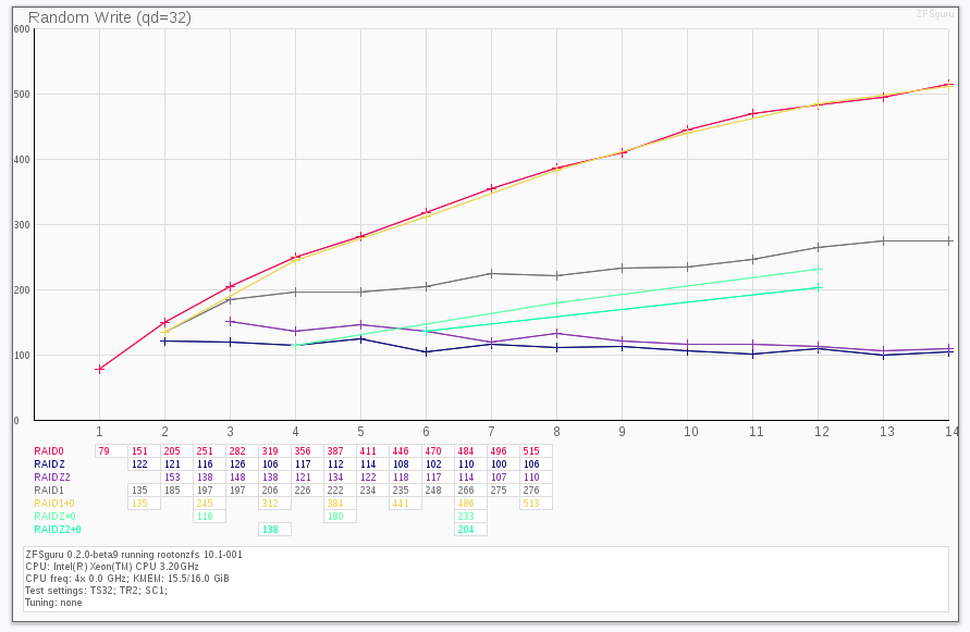

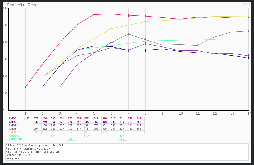

I've got to throw a coach's challenge. :) Take a look at these test results. I think something might have skewed your results.
http://zfsguru.com/forum/buildingyourownzfsserver/570#5242 (the x-axis in the graphs below is # of drives).
I just want to tell you how much I love this charts and the link. These are actual test , not a synthetic benchmarks like this dd comand everybody is doing. If you know more places like that I can look , please send them my way.:)
