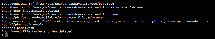

if i run the files:cleanup command i get the error:
"The process control (PCNTL) extensions are required in case you want to interrupt long running commands"
So: is ther any possibility to run the command nevertheless the plugin?

But the files:cleanup warning stops the process. How do i skip the warning?

here is the screenshot - not much information i think...

The 'occ files:cleanup' command is running properly, see the last line of output. What you said here https://forums.freenas.org/index.php?threads/php-extension-in-owncloud-plugin.46153/#post-314564 is incorrect, and I was correct in saying you can ignore the warning.
If you want to read the log you can output or edit the file /media/owncloud.log
cat /media/owncloud.log
ee /media/owncloud.log
