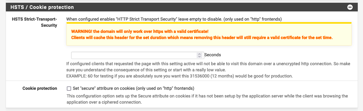

Edit: Actually, this probably isn't relevant to you, since Caddy isn't doing TLS termination for you. You'd instead need to set this on your pfSense box, wherever in the labyrinth of HAProxy settings it would be.

i actually read that but forgot about it in my quest to get the access to NC. I assume since my certs are generated through pfSense, i don't have any risk for lockout, right?
15,504
Then it's going to be a matter of making sure that process is reliable. I'd still probably wait a couple of months just to be on the safe side (Nextcloud likes to whine about things that don't really matter), but you can enable it now if you like--but again, it'd be on the pfSense box since that's where TLS termination is happening.

That would be here:
