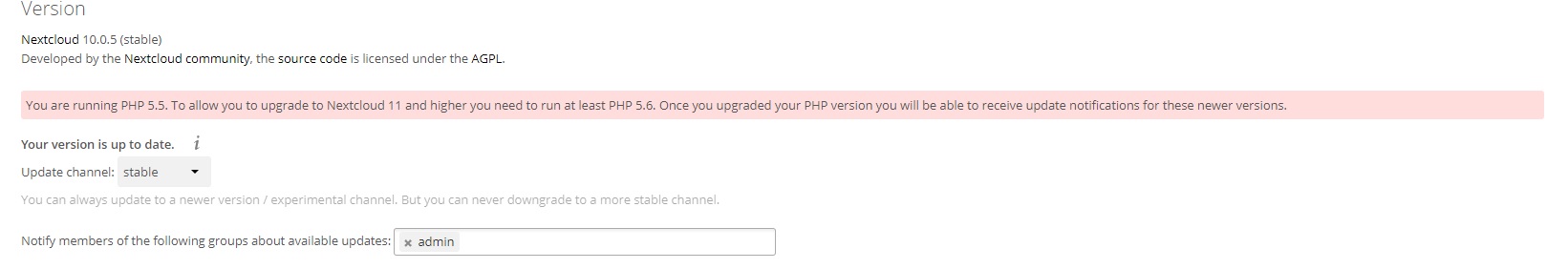

but nextcloud is still telling me that i am on php5.5

Probably have to stop php5.5 from starting up and modify so php5.6 is booting.
Enter the jail and then:
edit /etc/rc.conf
Should be something in there that points to php5 being enabled and you need php5.6.
Otherwise just make a new jail and start from scratch.
And Google is your friend, pretty much ANYTHING that you do in a jail on FreeNAS is the same as on FreeBSD since that is what FreeNAS is based on.

pkg delete php55 followed by service php-fpm restart.
Do note that if you have all of the php55 dependencies installed it will delete all of them too. You'll likely have to re install all of them to match the php version you are using.
Also is this a plugin or manual install in a standard jail?

Ok you can't update the packages that the nextcloud plugin was built with. You'll have to wait until the nextcloud plugin maintainer updates the plugin which isn't likely to happen since the plugins are going to change in FreeNAS 11.1.
You'd be much better served with a manual install in a standard jail that you can keep up to date yourself.
