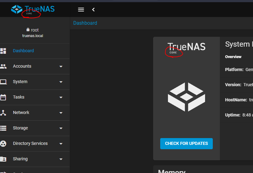

Especially since the curl isn't working from the jail it's hosted on I have a more generalized question. Do you know whether you are using Truenas Core or Truenas Scale? One way to check is to open up your dashboard it is in really small print though so decently easy to not notice. If you are on Truenas Core, would you be willing to share what guide you used to install Photoprism to a jail?
burakkusensei
Dec 3, 2018
16
Thanks for getting back to me again.
I'm on TrueNAS Core. And I basically winged it with the installation, starting from reading on the Photoprism website that there was a FreeBSD port of it but being unable to just install the package as per their instructions. After looking at the photoprism port for FreeBSD instructions on github, I wound up basically doing the following:

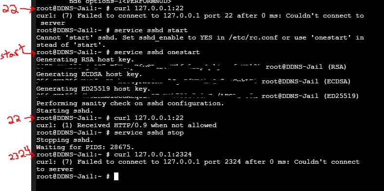

In the brand new jail when you # curl 127.0.0.1:2324 it is saying 'connection refused' instead of 'failed to connect'?
I used 22 as an example since turning ssh on is so simple

It is saying "connect to 127.0.0.1 port 2324 failed: Connection refused."
Ok, what that will mean is that there is something (some kind of application like your Photoprism) that is using that port within that jail that, when seeing curl's attempt to say hi, is slamming the door on curl's face.
What is the output of this?
# sockstat -4 -l
we are mostly curious in any output from it that has 2324 in the 'local address' column and what the 'user' and 'command' is for it.
