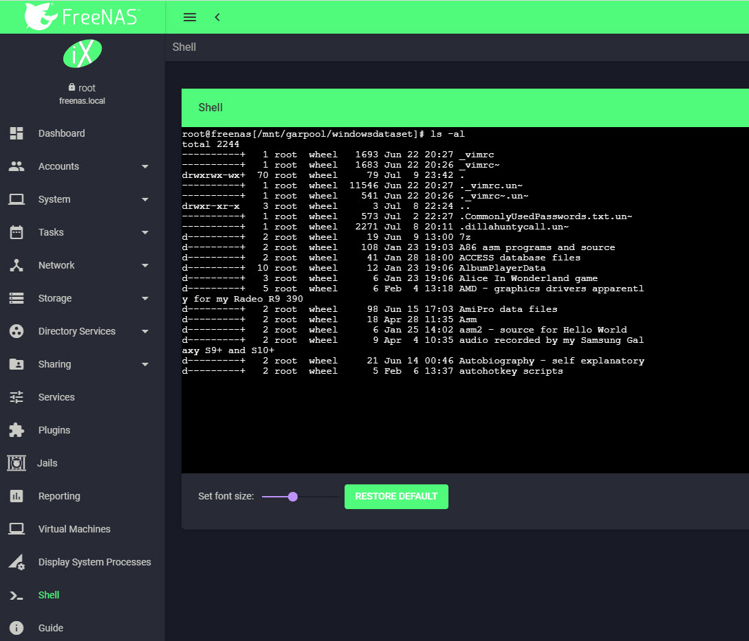

My pool is drwxr-xr-x. My dataset under that shows drwxrwx-wx+. But all my subdirectories under my dataset are d---------+ and all my files under all of my folders are ---------+. Even though i'm root, root won't let me do a chmod. I tried on one of my folders, Zip, chmod 755 Zip, and i get Operation not permitted. Do you know why i can't do chmod? It seems to me that if i could do that then i could fix my problem.

This looks like an ACL apply gone wrong. This may be ugly to fix. First, setfacl -b /mnt/garpool/windowsdataset to remove the ACL from the top level. The permissions are too far gone to let you apply this recursively. Run setfacl -b * at each level (don't forget the .dot files), which should then allow you to run the chown and chmod.

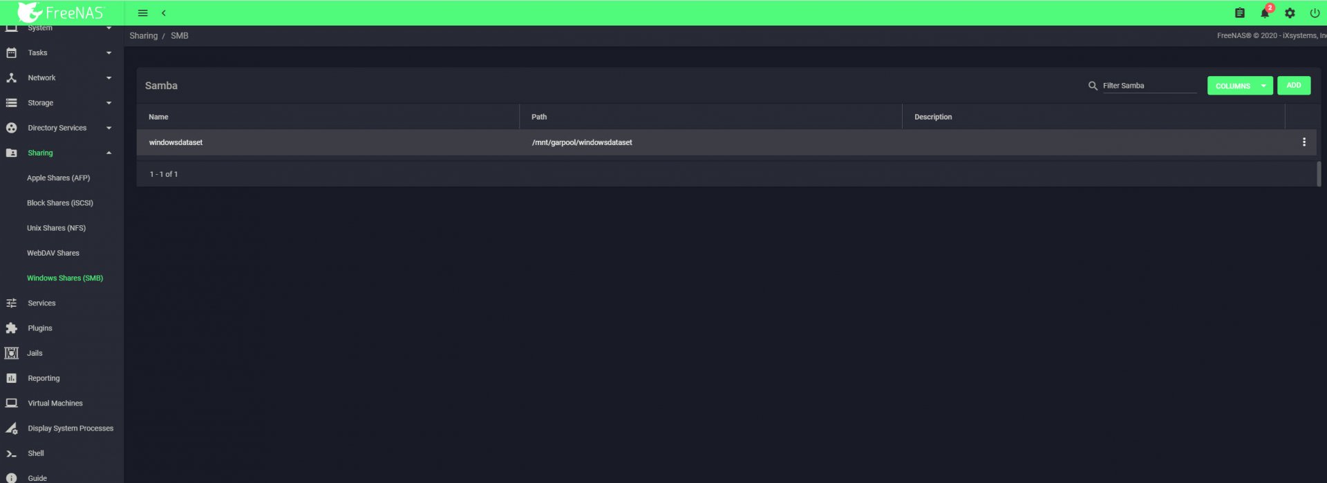

Samuel Tai
Apr 24, 2020
5,399

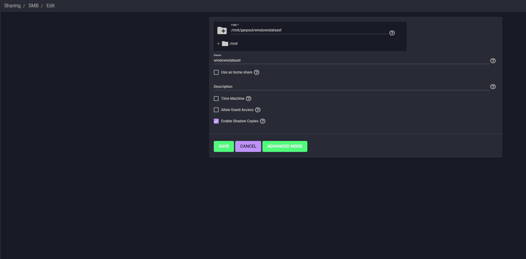

Actually, I need a screen shot of the edit pane for this share, and also how you attach to the share from Linux and Windows.

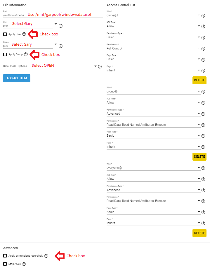

In that case, I recommend you set up your ACL like so:
garwhi
Jul 10, 2020
14
OK. I've done that. Still can't see it from my Windows box clicking on FREENAS under Computer under Windows File Explorer. I had this same problem when i first set it up a few months ago but googled the problem and went somewhere to fix permissions. But, unfortunately i don't remember where i went or what info i got from them to fix my problem. I spoke too soon. I just checked my Ubuntu box and i'm in! So glad to see my data again. So now if we can just fix my Windows 10 access problem.
