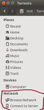

By connecting through the network I’m referring to the options at the bottom of the Nautilus file browser under the “Network” heading (Browse Network and Connect to Server). I’m a noob in Ubuntu as well, sorry if I confused you by using the wrong terminology.
