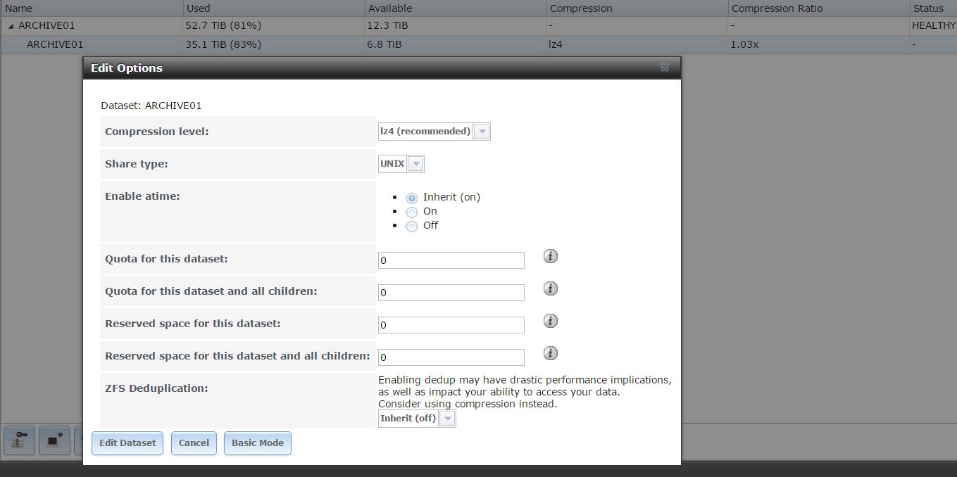

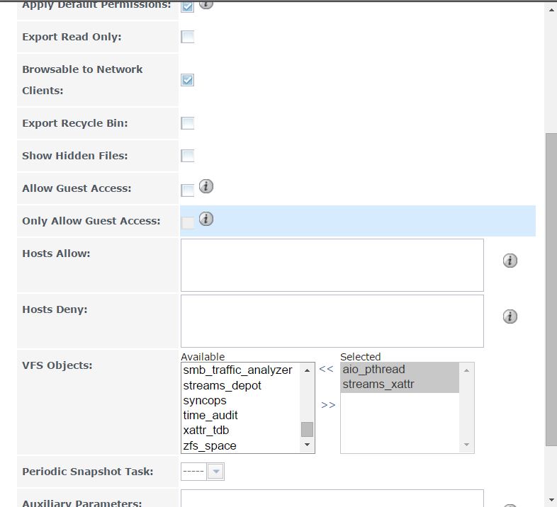

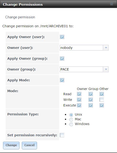

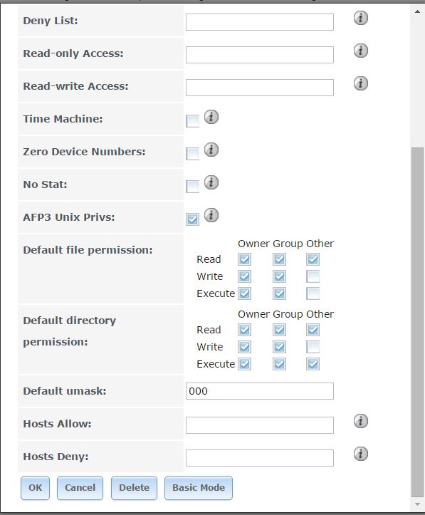

Hi everyone,
I searched for a solution but can't quite figure it out. I have a volume being shared mostly via AFP by macs and one SMB client via Windows. Permissions type on the volume is set to Unix, 775, group owner is the users group i created which all users are part of, user owner is nobody. see attached.
Reason I stay with AFP on the macs is because they seems to fully use the a dual gigabit LACP link to and from the FreeNAS (as well as other servers). SMB 2/3 only utilizes one link.
Here are the problems I'm facing which are always solved by checking the "Set permissions recursively" box:
1. workstation transfers, finishes, Get Info or Properties show 0 bytes and denied access when double clicking on any workstation.
2. workstation transfers, get an access denied error in the middle of transfer (haven't tried checking the recursive box in the middle of a transfer), quit transfer.
Is there a way around this? Am I setting something up wrong?
Thanks!

Your usage/understanding of lacp is wrong. Afp doesn't use it any better than smb. When using a protocol you need to set the permission type to match the system using it otherwise you will have problems like this.
Most people won't be able to help you solve your problem but try creating datasets and shares to test permission behavior.
