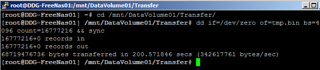

On to the DD test, this is what I did and hopefully it is correct:

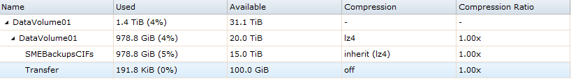

  1. Created a new DataSet and called it "Transfer"
    • Disabled compression:
  2. Created a new CIFs Share and called it "TransferCIFs" (this was just for viewing)
  3. Via Putty (over VPN)
    • CD to Transfer: cd /mnt/DataVolume01/Transfer/
    • Ran the DD Command: dd if=/dev/zero of=tmp.bin bs=4096 count=16777216 && sync
      • Is my command correct? Not 100% sure about if I should be using "/dev/zero" or something else?
      • Got similar results as when done initially (~326 MB/Sec)
    • Deleted the "tmp.bin"

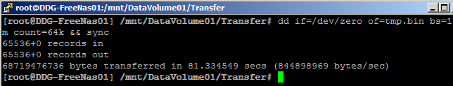

    • Ran the revised DD Command (per titan_rw): dd if=/dev/zero of=tmp.bin bs=1m count=64k && sync
      • Results were much better (~805 MB/Sec)
So with all that being said, perhaps it was the way I ran the DD Command? Even with it showing a much improved result, this still leaves me to ponder the time it is taking for the backups from the SME Server using DAR.

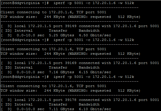

I have the same pool layout. 12 drives in 2 vdevs of 6 in z2. They are 7200 rpm seagates. Currently the server is very busy moving data around, but I still get ~900 MB/sec with a dd test. Try a bigger block size. 4k is pretty small for a sequential write test. I used bs=1m count=64k
As for CIFS, with my e5-1650 and intel 10gig 540's, I usually get around 600-800 MB/sec. Looking in top, it does look like samba is burning 80% of a core doing this, so I'm pretty close to the single thread performance limit. This is direct connect (no switch), to a windows 7 box over copper.
What does iperf give you? I think I got 9-9.5 last time I checked. Check 'top -SH' and look for the samba thread (while a cifs copy is going on). Is it eating a core?
Previously, I got 8.13 Gbits/sec. Just ran the test three (3) times in a row and averaged 5.58 Gbits/sec. While slower than before, I will look at that later. 5.58 is still a lot better than using a 1 GB connection.
Backups start at 00:01 am and I will try to hop on then to check the samba thread. Out of curiosity, did you want me to check the CPU usage on the FreeNas Server or the SME Server?
Thanks.
titan_rw

Out of curiosity, what is the speed of an interactive copy via windows explorer over to freenas? Maybe this is a backup issue.
Yea, cpu usage on freenas using 'top -SH' to see the individual threads.
The write performance of the disks seems fine though. I'd have expected a bit more from iperf however.
