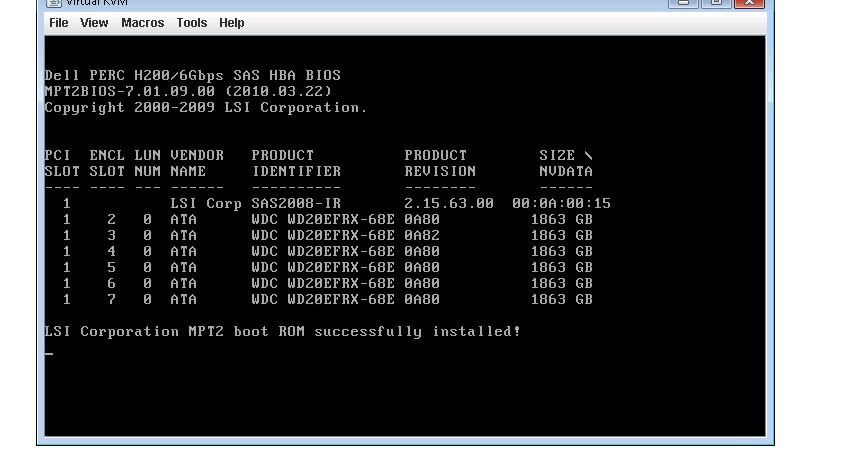

Hi, finally i've got this server with days of delay.
In a first run, with original firmware, the controller pass all disk without raid but with smart information; I can make a raid if I want (sure not now).
The server work well and pass all information to freenas, freenas only show a warning because firmware release 2 don't matched the driver release 16 present in freenas.
I did the flash procedure as your link and updated my H200 to sas9211-81 P16 , so to IT mode. The controller work perfectly and no more warning on freenas ;)
Thank you!

2? Holy crap, that's ancient. Even SAS3 is already at 3 or 4 (maybe 5 on some platforms). If you meant 20, it's also a good thing that you flashed the correct firmware, since stuff is known to fail hard with P20 firmware and the P16 driver.
The server arrived with H200 and original firmware in version 2 (see attached). It's old, sure, but I try to switch on and access by freenas and it works witouth problem. After this test, I've flashed the P16, so now firmware is 16 and driver also 16 ;)
