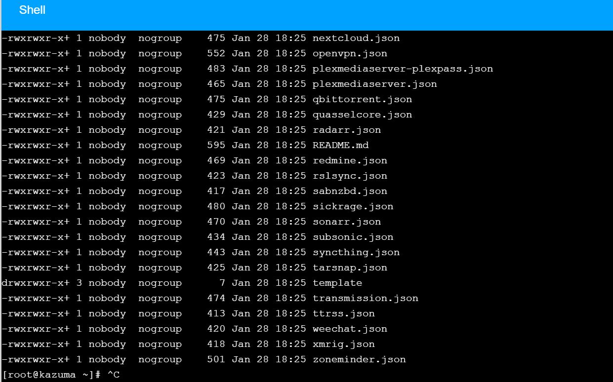

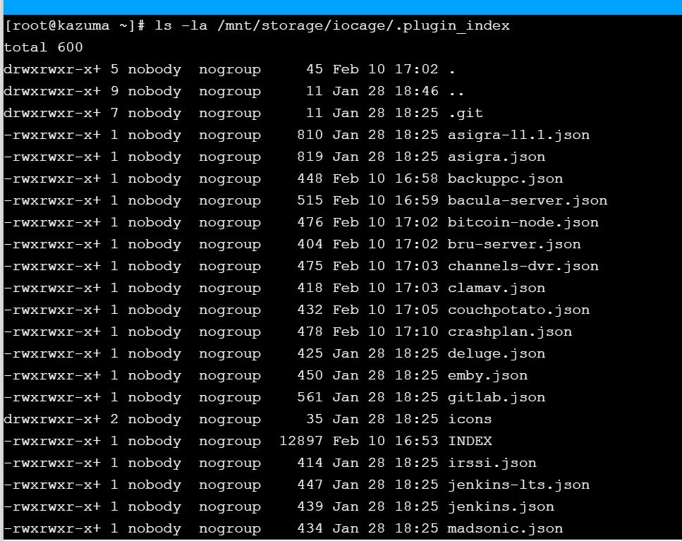

Can you post the output of the command ls -la /mnt/storage/iocage/.plugin_index/ between code tags?
Did you happen to share the iocage dataset (or your whole pool) and/or change the share type from Unix to Windows?
Kazuma
Jan 27, 2019
20
How do I copy and paste it from the gui or direct it to export to a file maybe? Or should I just screenshot and attach?
Jul 10, 2016
521
A screenshot will do. In the long run, install a real terminal client such as PuTTY if you're using Windows, as the built-in terminal is very limited.

The key is that there should not be plus sign at the end of the permissions column, e.g:
-rw-r--r--+  1 root  wheel    449 Jan 18 21:44 backuppc.json

Yeah, as I suspected, the screenshot indicates that somehow ACL permissions got attached to the plugins folder. A vanilla setup doesn't have this, and that is exactely what's causing the Traceback error RuntimeError: [Errno 1] Operation not permitted: b'/mnt/storage/iocage/.plugin_index/backuppc.json' as the ACL are preventing iocage from updating the plugins.
Changing the owner to nobody:nogroup won't fix this. Also, the iocage dataset is part of the data pool, so reinstalling FreeNAS won't do any good either.
I can only conclude this is self-inflicted and not a FreeNAS bug. At this point, it's impossible to know what other permissions were changed. Changing permissions and/or ownership of random files in the jail datasets are discouraged as this is likely to break the jail and may explain the issues you're having with plex.
At this point, you may want to delete that iocage dataset and recreate your jail(s) from scratch. Avoid sharing your entire pool or the iocage dataset; you can "mount storage" to add a specific folder to your jail (and just share that) or use WinSCP to move files between Windows and FreeNAS.
