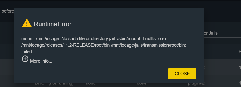

damatt2000
Newbie
Feb 22, 2019
I'm getting both errors. The one in ops post plus this one. I figured it has something to do with mounting the storage.
