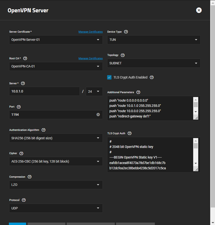

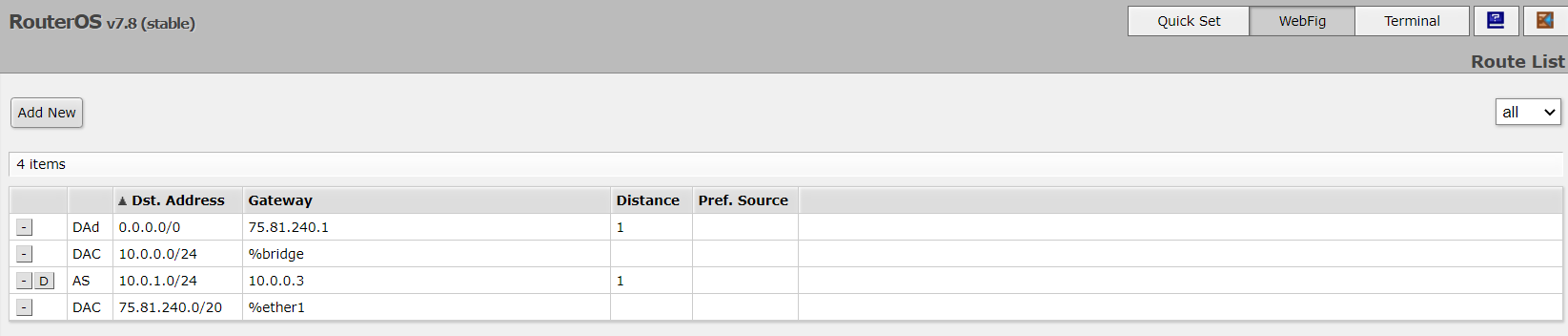

As stated in the initial post, I'm setting up a remote access vpn server on TrueNAS scale. When I connect to OpenVPN after initial server setup it does connect to the OpenVPN server but it doesn't do anything, dns stops resolving, and even though I am connected to the vpn, I am unable to ping or connect to the TrueNAS server. I have tried setting a static rout in my firewall pointing back to the TrueNAS server as mentioned in my initial post, and I have tried pushing the routs via additional parameters in the TrueNAS OpenVPN server configuration page. The topology is set to subnet. My internal firewall ip range is 10.0.0.x, my OpenVPN ip range is 10.0.1.x, my TrueNAS server ip is 10.0.0.3.
See attached screenshots, one is the route I set in the firewall pointing back to TrueNAS, the other is the OpenVPN server config page in TrueNAS. Let me know if there's any other info that's useful.
It's possible I didn't create the routes correctly, or maybe my additional parameters are all wrong, I'm really not sure what's wrong with my setup but I'd like to get it working. Just hoping to get another brain in on this issue than just my own.
