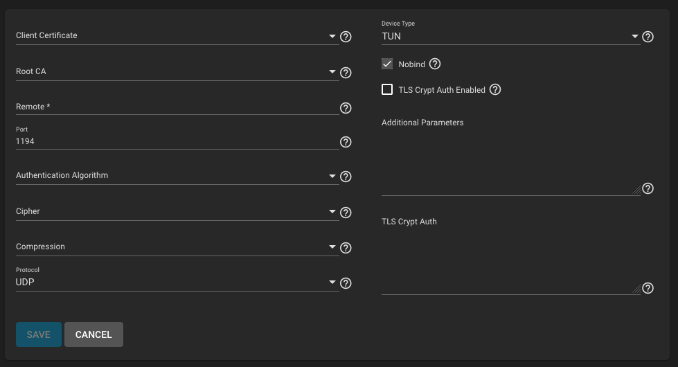

I'm looking into a scenario where I'd have a remote TrueNAS box connecting to my pfSense box via OpenVPN, so I could replicate to it from my main system. ZeroTier would have been perfect for this, but no, iX had to take that away (and never implemented it well to begin with). But no problem, TrueNAS now has an OpenVPN client, right?
Well... What I've done in the past is create the user (i.e., client) certificate in the pfSense web UI, then download the .ovpn file that contains all the relevant certs, keys, and other configuration settings. I can then import that into whatever client software I'm using, and configure the connection that way.
But I don't see a way to import such a file into TrueNAS. Instead, I see this:
Lots of manual settings, lots of ways to get it wrong. Am I missing something here?

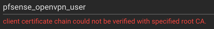

So the machine is here, TrueNAS is installed, there's no way to upload the .ovpn file (unless I ignore the built-in OpenVPN client service, and build a jail myself--which I'm not ruling out). So let's try to configure this thing.
I download the .ovpn file from my pfSense router, and open it up in BBEdit. It should have all the information I need, but thanks to TrueNAS'... idiosyncratic... GUI, it takes several steps.
  • Import the CA cert. Go to System -> CAs, Add, enter a name, set the type to Import CA, and paste in everything between <ca> and </ca> in the .ovpn file. Click Submit, and it saves with no errors reported.
  • Import the client cert. Go to System -> Certificates, Add, enter a name, set the type to Import Certificate, paste in the contents of the <cert> and <key> sections of the .ovpn file. Click Submit, and it also saves with no reported errors.
  • Now for the fun part. Go to Services -> OpenVPN Client -> Edit. Select the Client Certificate and Root CA entered before. Enter the FQDN of my pfSense box, set the auth and crypt algorithms correctly, compression, protocol, pre-shared key. Click Save, and get this:
Grrr...
