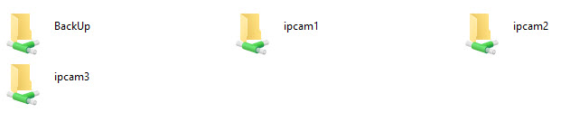

Can someone explain me in clear steps how to avoid the following problem.
I have one group account and two user accounts.
One user account for BackUps.
The other as CCTV for the IP cameras.
If I now log into windows with the username and password of the BackUp then the CCTV folder is also visible.
How can I prevent this?

You are seeing shares. You are not seeing folders. There's a difference. When you navigate to a server in Windows File Explorer "\\server_name", you are connecting to the IPC$ share on the SMB server and issuing a Remote Procedure Call (RPC) to the server to list all of its shares. This is generally the same for _all_ users regardless of operating system. This is how it works on Windows as well.
Typically Windows administrators will "map" SMB shares as network drives through the File Explorer GUI. Actual share paths are always of the form \\server_name\share_name. Ability to access shares is not impacted by the contents of the share browse list.
diedrichg
Dec 4, 2012
1,319
Uncheck browsable on one or more shares and map network drives, or configure "access-based share enumeration".
