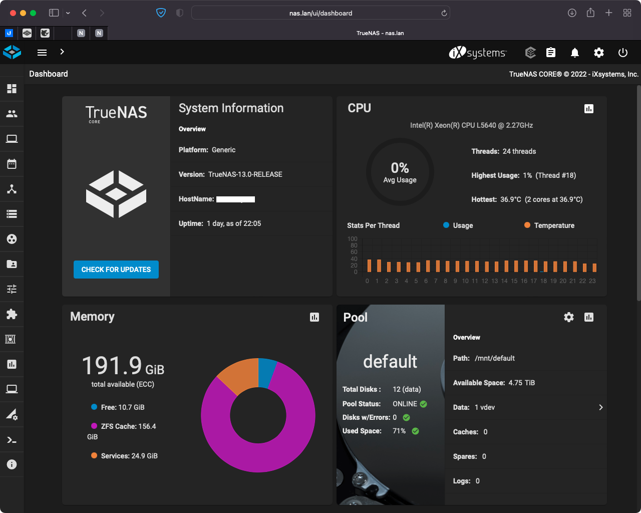

Daisuke
Jun 23, 2011
1,041
I purchased a Dell R720xd recently, will keep it for at least a decade. I rather spend the saved money for quality disks (which are way more important to last), I use 12 HGST Ultrastar He8 Helium disks for default pool and 2 SSDs for services pool. In contrast, I had a Dell C2100 for a decade with zero issues. Still going strong and super silent, like the R720xd (with the right firmware combination). The only reason I upgraded is to transform the C2100 into a backup for important stuff and keep it powered down. Dell have super robust hardware, never had a single issue with their servers, running 24/7.
My C2100:
