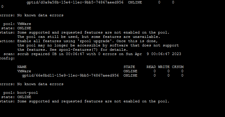

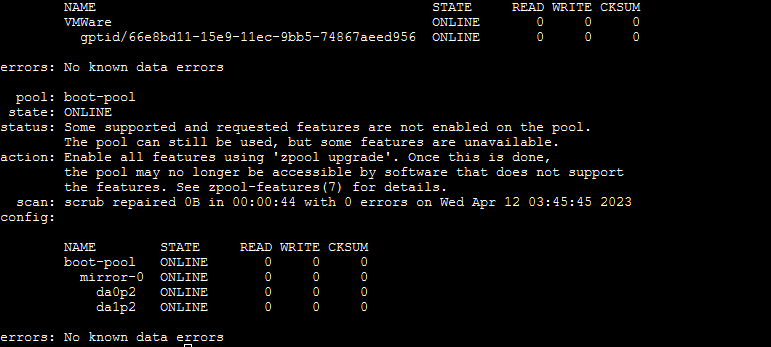

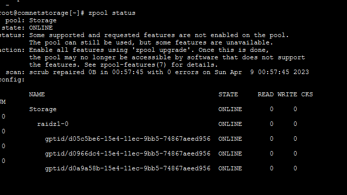

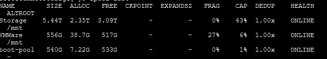

Hi Arwen,
thank for a prompt reply. it wouldnt let me copy paste, so please refer to the attached. this is on a dell T420 server running a perc710 Raid card, when assessing it, it doesnt not seem to support HBA mode, last time a mechanical drive failed, i was able to swap it out and update it in the raid, but then truenas wasnt reflecting the raid update.
the drives are currently all individually raided as raid0 so each drive on the system is seen as single disks and not apart of a hardware raided pool per say, but should a drive fail and i swap it out and update the raid controller the truenas system doesnt or didnt back then reflect it to rebuild the ZVOL, keep in mind this issue happen back with TN ver 12U so i dont know if any changes have been made since then till ver 13.
perhaps a feature that allows truenas to detect drives and add to the current pool as well as remove drives would be a very nice feature to have as well as work around this whole raid issue
You need an HBA with IT firmware loaded. There is no such thing as an "HBA mode"; it's a fiction to sell more expensive high end RAID hardware. See the article that you were referred to. You either need to replace the PERC with a PERC HBA like the H310 flashed to IT mode, or you can also crossflash the H710 to IT mode. Both ways you end up with an HBA.
It is not the "hardware raided pool" that's a problem. It's that there's any RAID in there at all.
It's this. Your RAID controller is designed to keep presenting the same set of volumes to the host; it is based on a mentality that assumes that there is redundancy, but there is no redundancy when you have your RAID0 individual devices. The RAID controller is designed to do something different than what ZFS needs, which is direct access to the raw disks. An HBA is fundamentally different in that it does not create virtual volumes.
TrueNAS has all of that, naturally. But you have to use the correct firmware. You need to flash the PERC H710 to make it into an HBA with IT firmware.
The workaround to trying to tow a full size camper with a VW Bug is to replace the VW Bug with a truck, not to find a "work around for the whole VW Bug issue". ZFS needs access to your disks. Hiding them behind a PERC RAID controller is not going to work and is unlikely ever to work. This is not the fault of ZFS or TrueNAS. It's because you need to understand that the job requires a truck, not a VW Bug.
