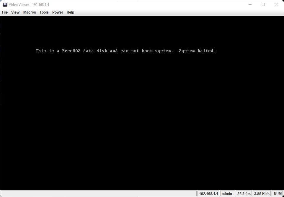

OK, a little progress. I was able to get vKVM working with a jank workaround. To validate my suspicions I was greeted with "This is a FreeNAS data disk and can not boot system. System halted. So it's looking at the wrong drives to boot. I guess I should check the BIOS to see that it's looking at the right boot disk.

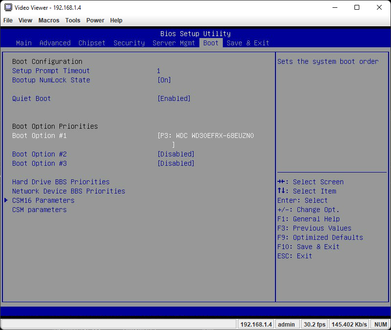

In the BIOS the only boot drive option now is just one of the three storage drives. I powered the server down and checked the connections. I don't really understand why not all the drives would show up... EDIT: OK, I went into Hard Drive BBS Priorities and set the boot drives properly to the SSD's and it boots into TrueNAS as before. Now the only remaining question is how do I do this properly.

Thanks. I actually was just about to post that I was able to fix it. I reinstalled the HBA and reconnected the boot SSD's to them. In the BIOS PCI settings I was able to configure it to look at the HBA. After save and exit (F10) I went back into the BIOS to find that it now showed the boot SSDs on the HBA! I am back into TrueNAS.
