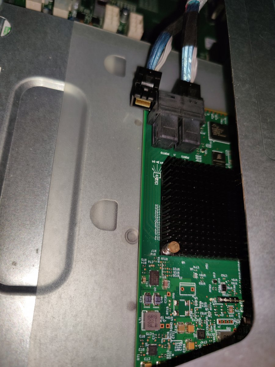

Hi all
Got a Broadcom SAS 9300-8i (with SAS3008) HBA with the latest firmware where I get I/O errors on Micron 5300 MAX SSDs when connecting both ports on the HBA to the BPN-SAS3-826EL1 backplane in a Supermicro server.
If I unplug one of the cables on the HBA no errors occur.
I haven't experienced this before with SAS2308. Does SAS3008 do some kind of multipathing that doesn't work with SATA connected drives on a SAS (and SATA compatible) backplane?
I'm hoping there's a configuration setting somewhere which could solve this, or I will need to remember to leave one of the cables detached :smile:

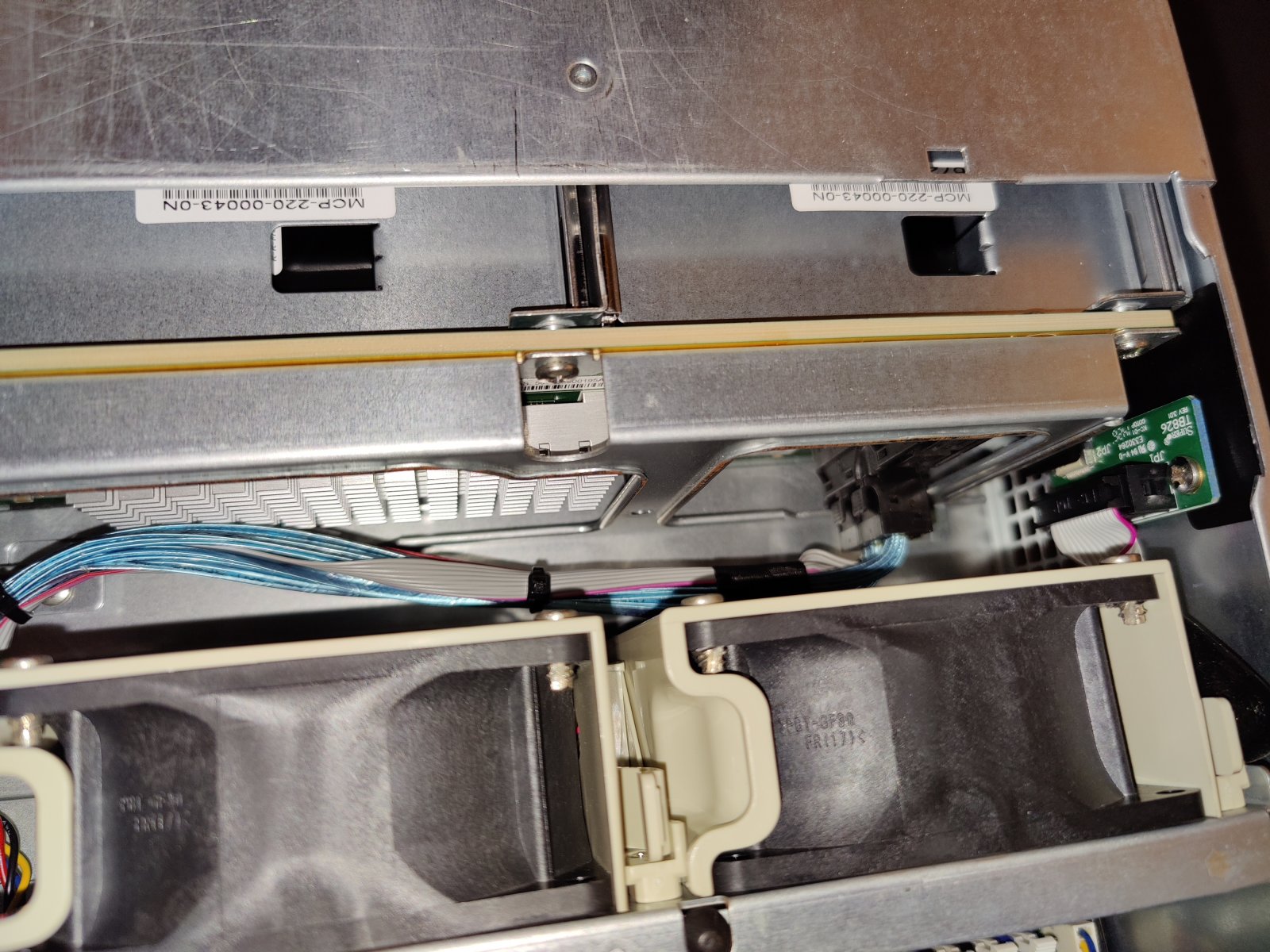

No, I have one working with the same expander and SATA SSDs in dual link without issues (with Linux though, but the OS is not likely the problem), possibly some compatibilty issues with the SSDs.

SATA is only on one channel, so maybe the SAS 9300-8i just needs only one link and not get confused.

I now have no errors with both cables and the latest firmware .10/.12. Very odd!
Tested with SAS disks. It's like when after I connected SAS disks one time it works, even after I disconnect them.
Attached an image of the backplane connections (haven't changed those, they are still in place like before). The server was originally assembled by others, and I guess the connection between HBA and backplane might have had an issue.
