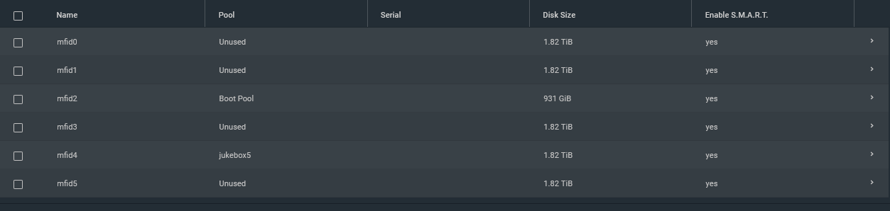

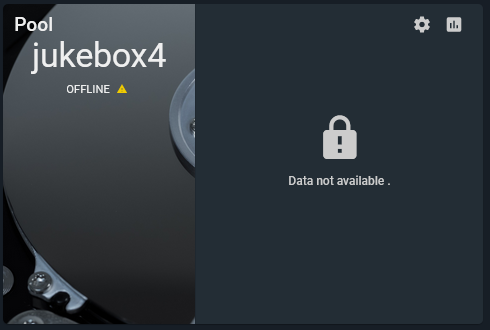

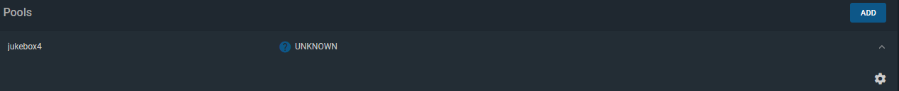

One of my pools have decided to go OFFLINE on me now and when I look into the drives area it shows this :
BOOT pool is just what it says.. for the OS
and Jukebox5 has data on it.. BUT missing is Jukebox4. It shows like this:
I do not know what the MFID is for Jukebox4 so I have NO IDEA what one of these marked "Unused" is the drive.
How do I :
1) Figure out what drive it is that Jukebox4 resides on
2) recover all that data
3) get the pool back online

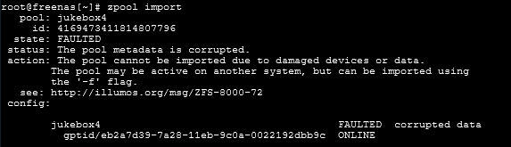

Sorry for the multi posts.. Just want to give you guys as much info as I can. I ran zpool import and got this :
any idea how to fix this issue to recover my data and what caused this data to be corrupt?

Would I be correct in interpreting that you have some sort of LSI RAID controller attaching your disks?
Ditch it.
Indeed ditching the RAID controller is a good idea if you want to continue using TrueNAS.
However, if you were hoping for some kind of chance to recover data, don't do that just yet.
You can try the import with a -F and see if dropping the last few transactions can make the pool importable.
After that, get your data out (if you can) and ditch the RAID for an HBA.

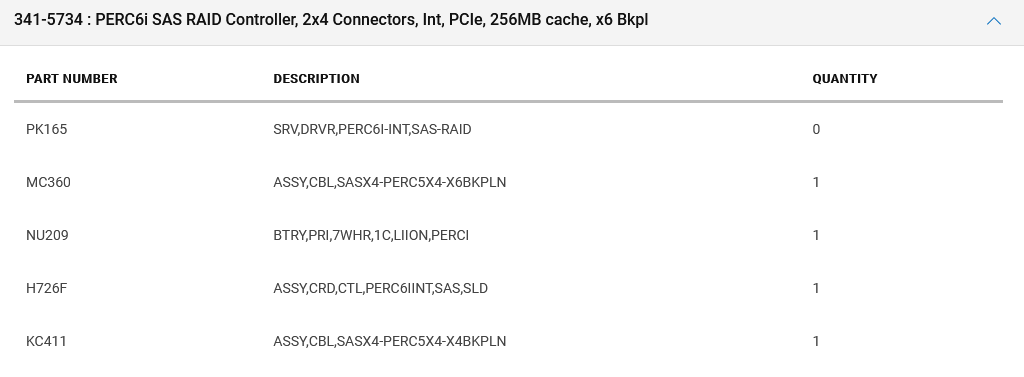

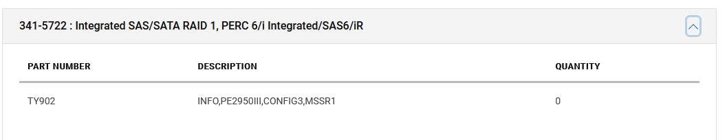

Could not get the box out of the rack today but here is some info i got from the orig config sheet on the unit. Let me know if this
helps
jgreco
Resident Grinch
May 29, 2011
18,680
Yeuck.

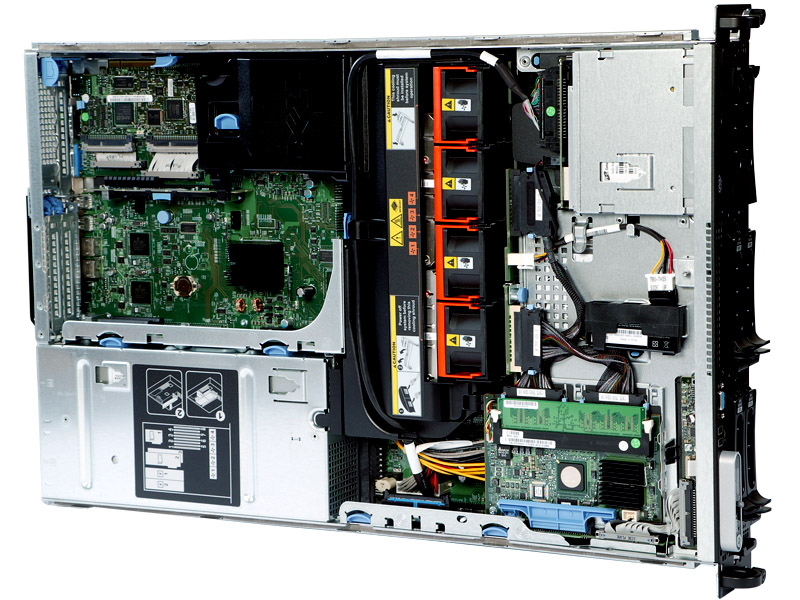

Okay, running the KC411 thru the eBay meat grinder suggests that this is a very short SFF-8484 to SFF-8484 cable, which raised my eyebrows until I saw
this picture which shows a slightly perplexing design where they have the card up front. But you "done good" because this gives us a discussion starting point.
So this server looks like it only has six bays in it. I can only imagine that they were trying to keep slots in the back free, which is the usual reason for the PERC "internal" designs, but usually I've seen those mid-chassis (R510 etc), not sitting up front. I suppose they were trying to keep the space open for "large" cards.
Anyways, the backplane ... If those are actually SFF-8484 on the backplane, then I think you might want to try two cables like these
and replacing that controller. A PERC H200 crossflashed to IT might be able to be cabled into the existing "internal" RAID slot, else I would suggest a PERC H310 crossflashed to IT mode installed in one of the rear slots.

It's not clear exactly what's happened, and I'm not a ZFS data recovery expert.
You can safely ask FreeBSD what kind of partitions are on a given disk using "gpart list <device>", so for example if you were to try "gpart list mfid4" I would expect you'd probably find a provider, maybe mfid4p2 listed as "type: freebsd-zfs". That corresponds to your "jukebox5" pool. Look at the "rawuuid" and it should correspond to what is listed by "zpool status jukebox5".
This will help you identify which disk might be holding your missing pool.
Now, you can try to force an import, as ZFS indicated to you in your post #3, and as @sretalla discussed in #5. Personally, I wouldn't do this without having a backup disk image, but that may be beyond the scope of this discussion. I am typically very cautious about this stuff.
