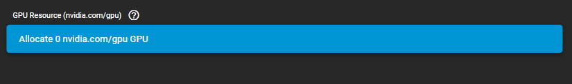

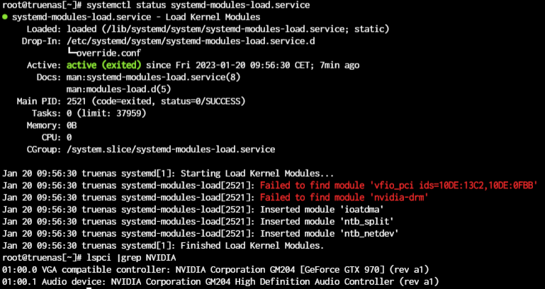

I have never had mine isolated but now discover that it is not available in my Plex app. It is detected nvidia-smi but am getting the "Failed to find module 'nvidia-drm'" error when typing: systemctl status systemd-modules-load.service
I'm really pulling my hair out here. Constant issue with offocial plex on Truenas scale Bluefin
Looking back to my post it seems that I state that the solution is to make sure it is not isolated. To clarify, this did not resolve my issue.
I do not think this is an issue with plex, this is an issue with truenas itself. I am having a lot of issues with my apps after the upgrade, this is the last one left to be resolved.
