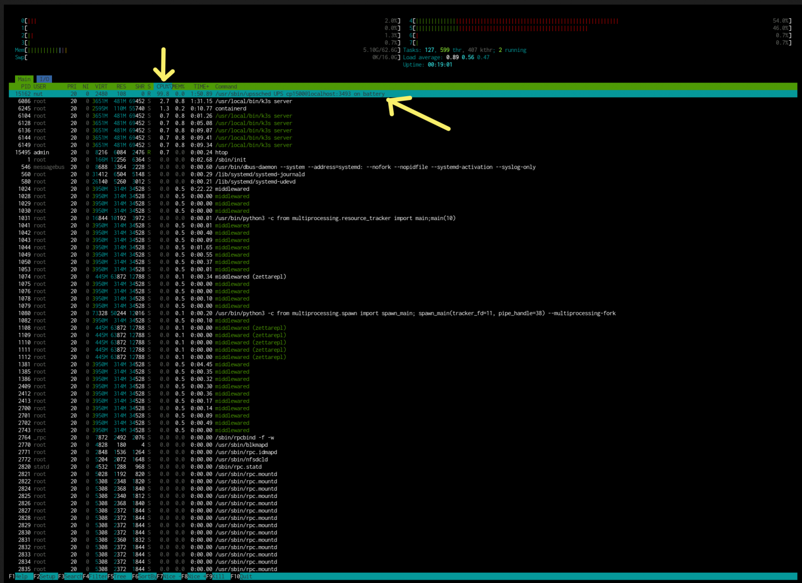

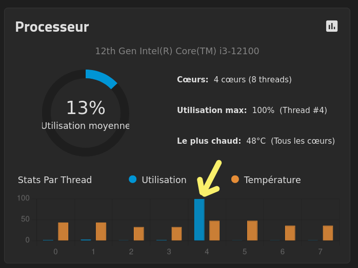

Here's more detailed info on the situation on my TrueNAS Scale while in UPS power loss:
A process named 'upssched' uses 100% of one CPU thread (user: nut).
