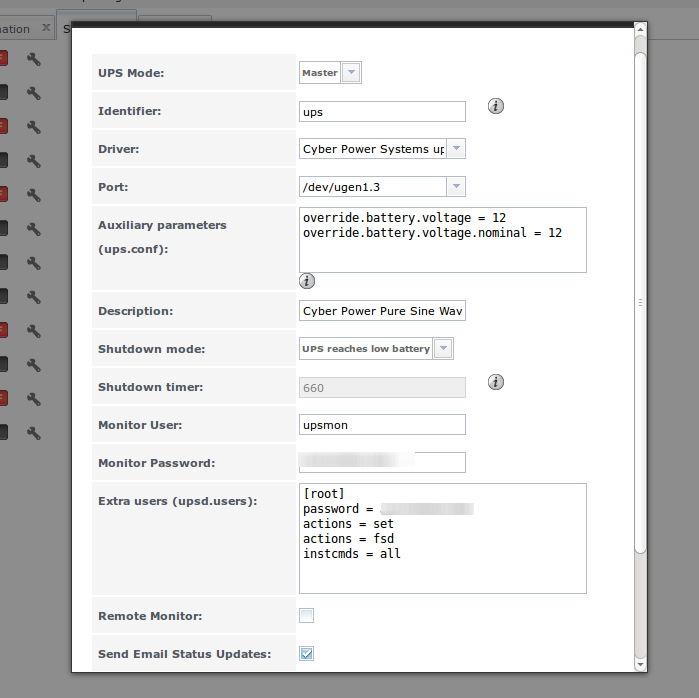

Yatti420
Aug 12, 2012
1,437
With Overrides..
[root@NAS] ~# upsc ups
battery.charge: 100
battery.charge.low: 10
battery.charge.warning: 20
battery.mfr.date: CPS
battery.runtime: 2910
battery.runtime.low: 300
battery.type: PbAcid
battery.voltage: 12
battery.voltage.nominal: 12
device.mfr: CP850PFCLCD
device.model: CRDA103*AF1
device.serial: CPS
device.type: ups
driver.name: usbhid-ups
driver.parameter.pollfreq: 30
driver.parameter.pollinterval: 2
driver.parameter.port: /dev/ugen1.3
driver.version: 2.7.1
driver.version.data: CyberPower HID 0.3
driver.version.internal: 0.38
input.transfer.high: 139
input.transfer.low: 88
input.voltage: 121.0
input.voltage.nominal: 120
output.voltage: 137.0
ups.beeper.status: enabled
ups.delay.shutdown: 20
ups.delay.start: 30
ups.load: 13
ups.mfr: CP850PFCLCD
ups.model: CRDA103*AF1
ups.productid: 0501
ups.realpower.nominal: 510
ups.serial: CPS
ups.status: OL
ups.test.result: No test initiated
ups.timer.shutdown: -60
ups.timer.start: -60
ups.vendorid: 0764
[root@NAS] ~# upscmd -l ups
Instant commands supported on UPS [ups]:
beeper.disable - Disable the UPS beeper
beeper.enable - Enable the UPS beeper
beeper.mute - Temporarily mute the UPS beeper
beeper.off - Obsolete (use beeper.disable or beeper.mute)
beeper.on - Obsolete (use beeper.enable)
load.off - Turn off the load immediately
load.off.delay - Turn off the load with a delay (seconds)
load.on - Turn on the load immediately
load.on.delay - Turn on the load with a delay (seconds)
shutdown.return - Turn off the load and return when power is back
shutdown.stayoff - Turn off the load and remain off
shutdown.stop - Stop a shutdown in progress
test.battery.start.deep - Start a deep battery test
test.battery.start.quick - Start a quick battery test
test.battery.stop - Stop the battery test

Yatti420
Aug 12, 2012
1,437
Just wanted to confirm the pure sine wave series from Cyber Power seems to be working no problem with NUT.. Cyber Power Systems - CP850PFCLCD - Working with usbhid-ups
See ya,
battery.charge: 100
battery.runtime: 2580
battery.voltage: 12
device.serial: CPS
device.type: ups
input.voltage: 122.0
output.voltage: 138.0
ups.delay.start: 30
ups.load: 14
ups.productid: 0501
ups.serial: CPS
ups.status: OL
ups.vendorid: 0764
load.off - Turn off the load immediately  ** (Immediate Power Off - Don't Run This))
load.off.delay - Turn off the load with a delay (seconds) ** (Immediate Power Off - Don't Run This))
