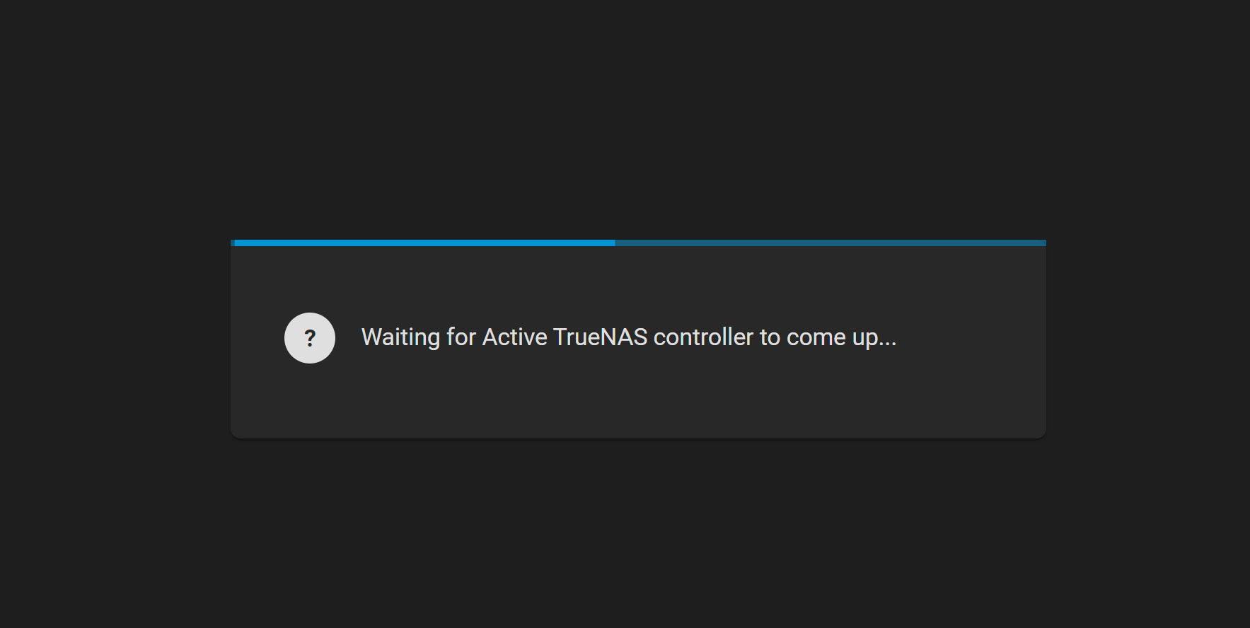

Good morning
My forum search identifies this issue as pertaining to running TrueNas Scale within a high availability environment. My version of TrueNas (TrueNAS-SCALE-22.12.2) is running bare metal on a single server with no Enterprise license.
I initially thought this was a networking problem, but it seems the "Active Controller" pertains to the storage controller on the active or standby host. Am I misunderstanding what I'm reading? What steps can I take to correct this?
Just an FYI, the three virtual machines I run on the host have no issues or pausing while accessing them through Remote Desktop.
I suspect this may be a poorly-worded error message. Do you have any reverse proxies or other things that might be blocking some of the connectons the WebGUI needs?

No reverse proxies being used. I should have added this issue started over a month ago at which time I thought it was related to Pfsense. That was not the case.
TrueNAS SCALE does not support high availability; this is exclusively a TrueNAS Enterprise feature (paid).
Its a little pedantic, but TrueNAS SCALE software has an HA capability which should only be enabled when running on a TrueNAS HA appliance. The HA code is enabled with an Enterprise license.
It is possible that some error messages might be confusing. I'd recommend updating to 22.12.3 and then troubleshooting.

Just an update:
  1. I use pfSense CE to manage my home network
  2. My WEB-ui and TrueNas Scale Server resides on NIC # 1 with VLAN subnet 10.20.0.0/24
  3. The mini PC I accessed My WEB-ui with was on NIC # 2 VLAN subnet 10.20.3.5
  4. The "Waiting for TrueNas Controller..." error occurred roughly every 30-45 seconds
  5. This configuration was used with both subnets set with DHCP on and without setting up a bridge network.
  6. Properly setup a bridge network and only NIC # 1 VLAN subnet 10.20.0.0/24 with DHCP
  7. Accessing my WEB-ui while still on NIC # 2 VLAN subnet 10.20.3.5 continued to produce the same error
  8. Decided to switch the mini-PC's subnet
  9. Switching the mini-PC to the server/WEB-ui VLAN subnet of 10.20.0.0/24 appears to have stopped the error
  10. For the moment I am trying to research a possible pfSense rule configuration issue
  11. Switching the mini-PC back to its original VLAN subnet of 10.20.3.5 produces the error immediately
