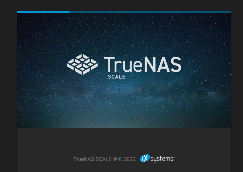

Second, right now the repeatable issue doesn't actually show the "Waiting for Active TrueNAS Controller" message. Rather, it jumps to a "/ui/sessions/signin" route but gets stuck showing JUST the logo with an "indeterminate" progress bar at the top:

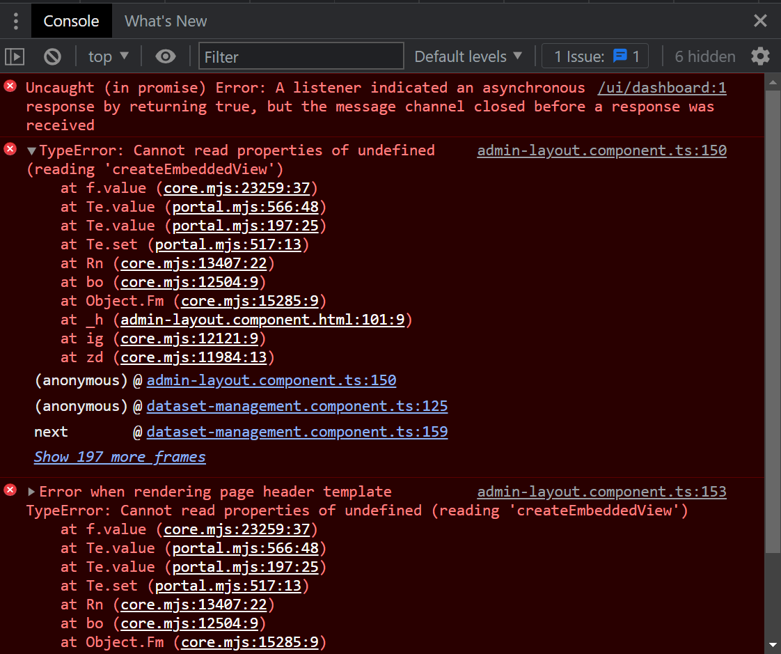

Fourth, loading that Datasets tab does incur a couple of JS errors in the developer console, though I think they might just be coincidental. The first message below happens on load for all browsers, but the second and third happen on all browsers except Firefox when the Datasets tab is activated:

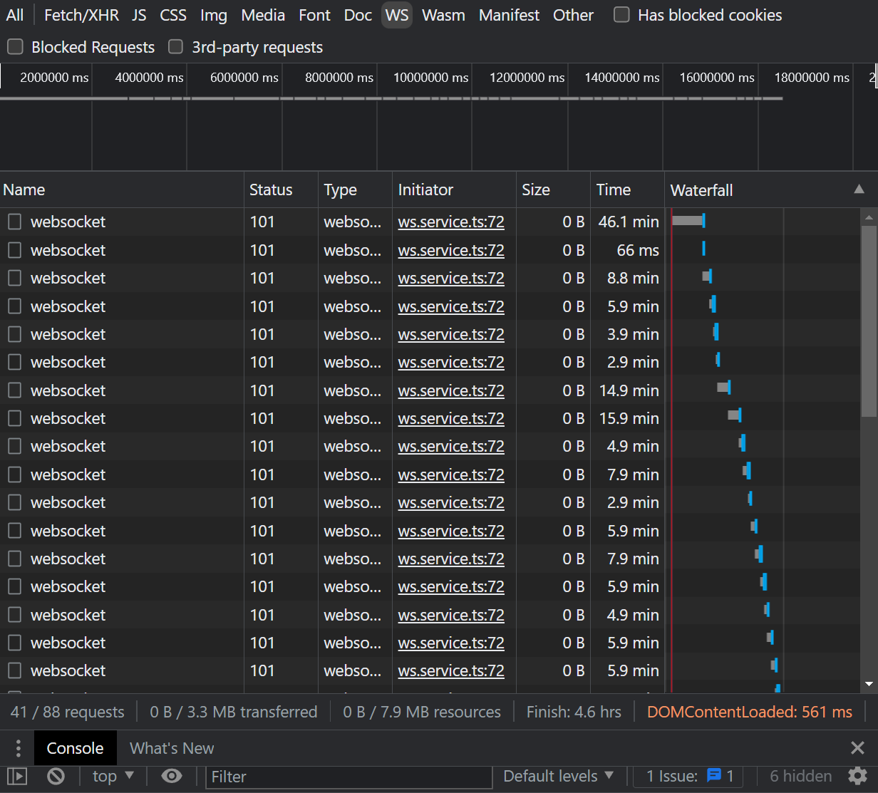

Fifth, and I think demonstrating the result (if not the cause), is that the chromium browsers keep closing and respawning WebSockets. Firefox has no issue with the single WebSocket staying alive and thus does not attempt to log out/redirect, whatever.
The pattern is similar across browsers and platforms, but the exact time is not. Basically a long'ish period (46 minutes here in Chrome on Windows and basically 1 hour on Edge and Mac/Chrome. That socket contains a LOT of ping/pong messages...just keep-alive stuff. Dies without a message. This is followed by a sub-second re-connection attempt that is unsuccessful, ending with what seems to be a request for "pool.dataset.details. and closing with this error message:
  1. error: {error: 13, type: null, reason: "Not authenticated", trace: null, extra: null}
  2. id: "d02327a4-1ff7-1dc4-b7a1-f04d7407afca"
  3. msg: "result"
All of the remaining socket connections are just "connect", "connected", "ping", "pong", "ping" and so forth until the socket drops and it is recreated.
And again, Firefox has ONE socket that just plays ping pong every 20 seconds forever. No issues.
If others can't reproduce this behavior, then perhaps this is a "hiccup" in the network connection that is not being handled as gracefully by Chromium as it is by Firefox. But the regularity of the closing of the WebSockets following the first failure...same pattern but different timing in all browsers...but almost always something.9 minutes...doesn't feel like a network-layer issue anymore.
