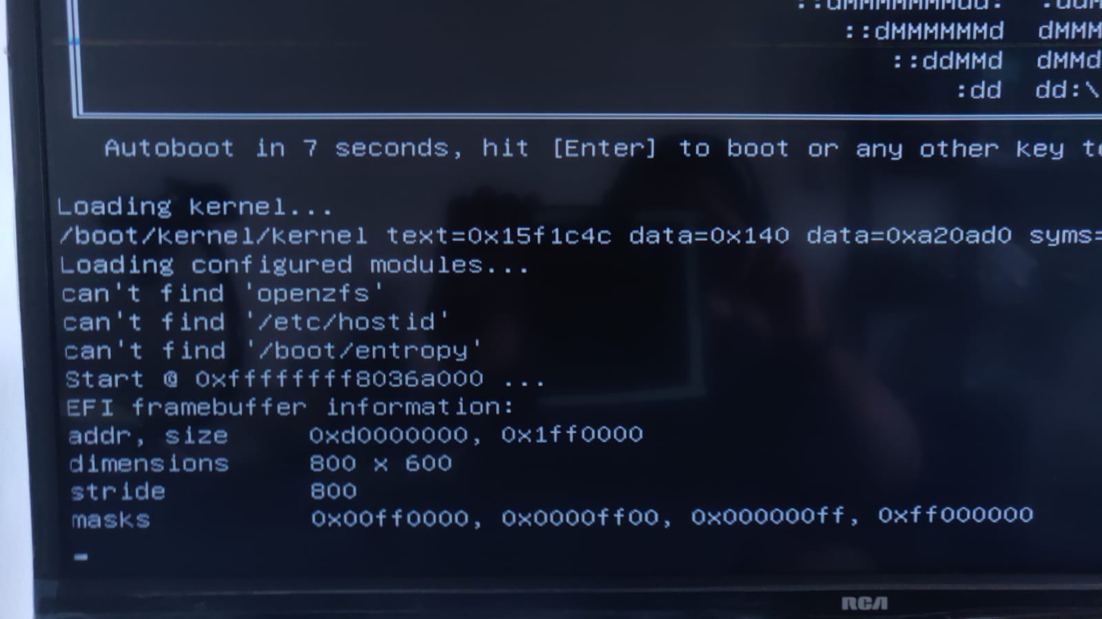

Tried searching for the answers in the forum; found few --tried to follow the steps but still having the issue.
System using is : Acer Aspire X1930 with Inter Pentium CPU 2.60Ghz, 2 Cores, 16GB RAM, 2 TB WD HDD for storage, and 32GB Scandisk USB for boot drive and have 1 other 16GB USB drive for installing.
checked the installation iso file with Hash- and is verified.
Currently, when trying to boot from the USB, it goes into bootloop. used 2 different usb drives; and also tried to create the bootable usb using Rufus and win32Image writer.
As shown below, it goes up to the line masks; and the system reboots.

Almost sounds like an issue with EFI booting on FreeBSD. Two things you can try:
1. Switch to legacy/BIOS boot mode in your bios settings
2. Try TrueNAS SCALE (Linux Based) to confirm if its a BSD specific issue - https://www.truenas.com/download-truenas-scale/

leo9848
Oct 8, 2020
updated the bios,
Downloaded TrueNAS ; a different set of USBs and this is the error.
Changed the SATA controller to IDE.
