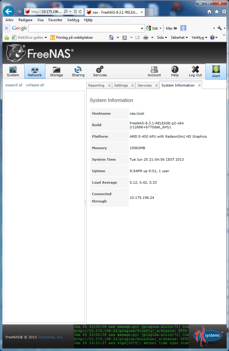

One problem is that the Tree View to the left is missing/empty and the GUI cannot be used to change
things like the Jail IP.

I expect not getting the tree view is the core of my problems.
Just get the links "expand all" "collapse all" and then below, an empty box.
(See attached picture)

OK, Not getting the tree view, was due to me using Internet Explorer 10.
I get the tree view in Firefox.
