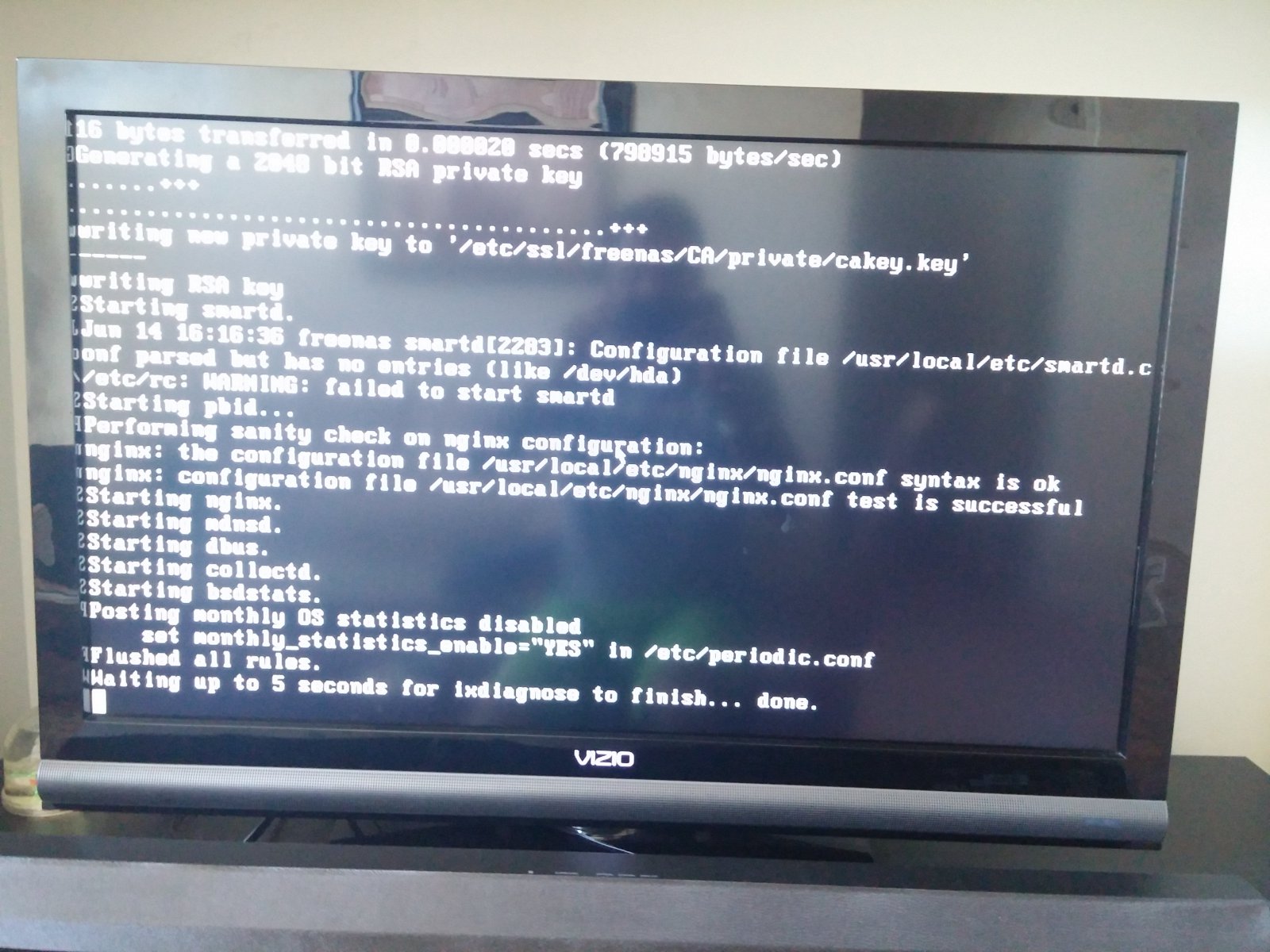

bro ...i just tried 9.2.19 and i was able to boot from usb flash drive but it is stuck on "waiting upto 5 seconds for ixdiagnose to finish......done".
i have attached picture here
thanks for helping me bro....

I'd like to again offer the suggestion that the GPT partition table on the boot device in 9.3 is a strong suspect. @madaim, what happens if you try 9.2.1.9?
ok....finally it is working now...took about 30 mins to boot. is it normal? am i stuck at 9.2.1.9? cant upgrade?
15,504
Well, you've shown that your system, at least in its present configuration, won't boot from a GPT-formatted USB stick. If there's a BIOS upgrade available, that may help. Otherwise, you may need other hardware.
