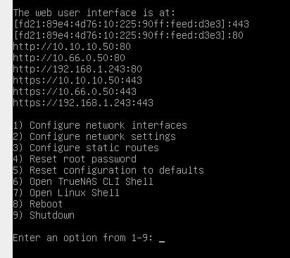

Hi all, a little help needed please.

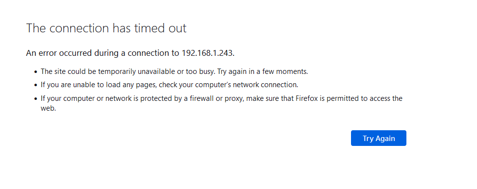

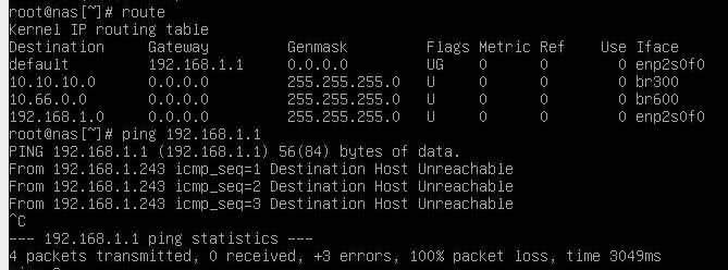

After migrating from Core to SCALE (release train method) I have no network connectivity in or out of the SCALE host. The interface will configure itself via DHCP, or accept a static IP and the interface is UP, but the host will not respond to WebUI/SSH or even Ping on that IP. Similarly I cannot ping out to the default gateway from the SCALE host (even though that gateway is the very same DHCP server that configures the interface via DHCP).

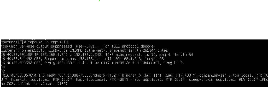

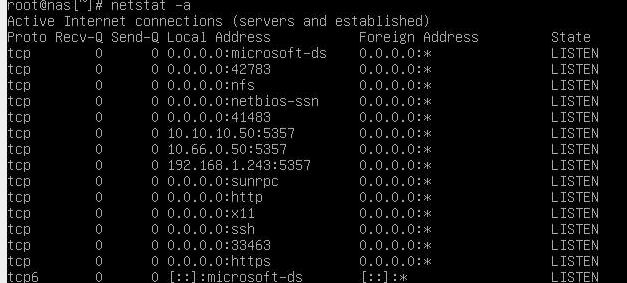

If I tcpdump the interface on the SCALE host I see all the normal network chatter (STP/ARP etc) and I can also see in the incoming PING and https requests from my desktop client - but no responses out from the SCALE host, so I can rule out any external network/routing problems. It's like the interface is physically up but not plumbed into the linux host/services properly, yet netstat shows the services bound to 0.0.0.0.

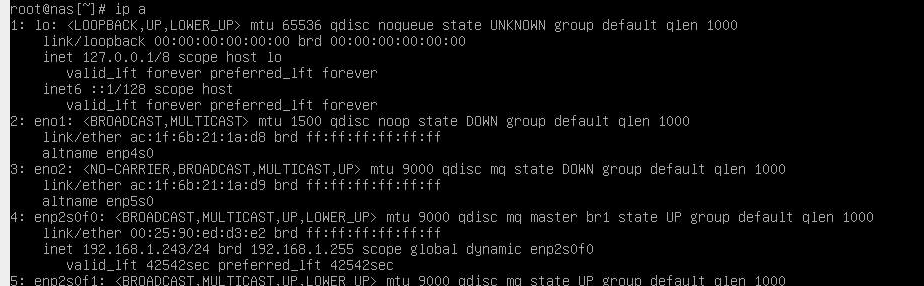

Taking some inspiration from a post here I took a guess that it was one of the vlan/bridge interfaces that was somehow interfering with the network setup, so I took the nuclear option and deleted all interfaces except the primary one, this fixed this issue.
I suspect, though can't confirm, it was the 'br0' bridge that was migrated from Core for VM communication, of which the primary interface enp2s0f0 was a member that got fubar'd during the migration.
