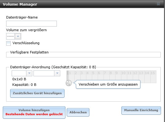

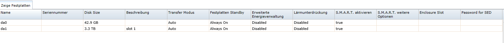

Hello, folks,
I have a problem with my FreeNAS installed on an ESXI: I can't select hard disks to create volumes even though they are displayed in the show Disks view.
Many thanks for the help in advance.

If I'm reading you right, you're saying that you see da1 in the list of disks and want to use it, but don't see it in the second screen to create a volume/pool.
This will happen if da1 already has data on it. You can try to wipe da1 (assuming that's fine for you) on the view disks screen, then try adding the volume.
FinnWuerde
Nov 14, 2018
Do you mean that I should remove da1 and then go directly to the screen where the volumes are created. Or should I format da1 completely once?

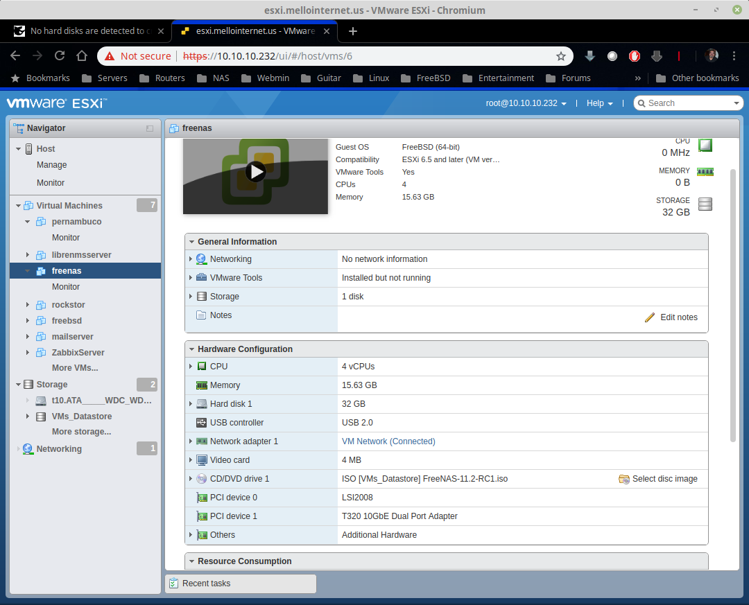

melloa
May 22, 2016
1,749
Could you please provide more information about your VM? Something like the pic would be nice, also: Any passthrough HBA?
9,700
Select da1 and use the wipe button.
