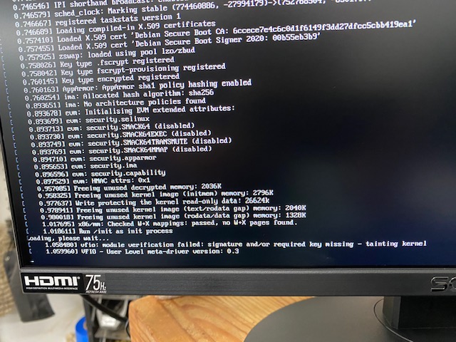

After upgrading to 23.10.1 my VM (debian) became inaccessable - I was no longer able to access the video card in the GPU selection configuration. Also when I booted up I was not getting any video from the VisionTEK 4350 for the console access (I almost always just connect via LAN using PuTTY). I rarely use the console - it's on a switch.
I had:
* GT710 SL (1 GB) - that I added to have a 2nd card for the VM
* Old VisionTEK 4350 - basic video card used for a console
I replaced the VisionTEK 4350 with a RTX2060 that recently was retired, and got the following error (console connected to the RTX2060).
vfio: module verification failed: signature and/or requrie key missing
VFIO - User Level meta-driver version: 0.3
I get the same error message with the RTX2060 and the GT710 SL.
With only the RTX2060 inserted, the console works, but when I try to attach the RTX2060 it fails "At least 1 GPU is required by the host for its functions and With your selection, no GPU is available for the host to consume" for the VM.
For some reason, after upgrading it seems I can only have 1 video card now. Current Truenas Scale Version: TrueNAS-SCALE-23.10.1.3

Thanks for the reply @HoneyBadger, It’s not booting past the vfio errors no ping response, no webui. If I try again on my bench, then remove the 2nd video card and boot it the office. Is there a log file I can send?
I downloaded a rescue linux and put that on a usb stick to boot up and can use lspci to verify the video cards before doing the single card Trunas boot. However the 2 older cards worked fine on the prior version of TrueNas Scale. I won’t be able to do that until tomorrow though.

Hi @HoneyBadger - sorry for the delay. The monitor on my workbench died and had to order a new one. Back in business again to test.
Original Configuration tested again (that worked prior to the TrueNAS Scale upgrade):
ASUS GeForce 710 with VisionTech AMD/ATI-RV710
After upgrade - console hangs - VFIO error. Booting with Linux Rescue shows both cards using lspci.
Also Tested:
ASUS GeForce 710 with RTX2070 - VFIO error also. Booting with Linux Rescue shows both cards using lspci.
RTX 2070 and VisionTech - boots to TrueNas console but no web UI even waiting 1 hour. TrueNas Scale console shows both cards using lspci.
ASRock B550M Pro4 Motherboard with AMD Ryzen 5 3600 64 Gb
Ideas about getting some good information to you? Right now I only have the RTX2070 installed so I can use the server - so cannot start the VM. System starts with the ASUS GeForce 710 only but cannot start Jellyfin. With the RTX2070 installed all my apps work including Jellyfin; but no VM.

Thanks for the reply @HoneyBadger . Check the jpg - when I have 2 gpu cards installed my linux boot stops with the vfio error. No web UI, no console, no network. Doing the command you listed above midclt I get error: cat/0 not defined.
