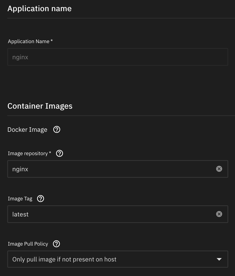

This can't possibly be any simpler, but here are the screenshots:

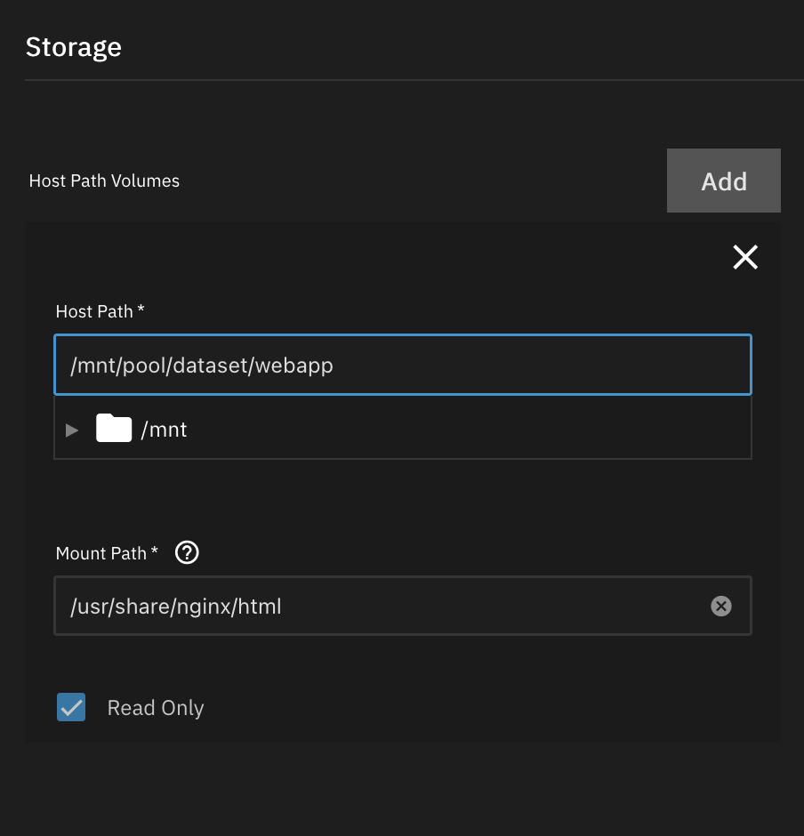

Put your contents in /mnt/pool/dataset/webapp (or whatever path you will use for the host path you mount.
Create a new custom app:
Use nginx for the image repository

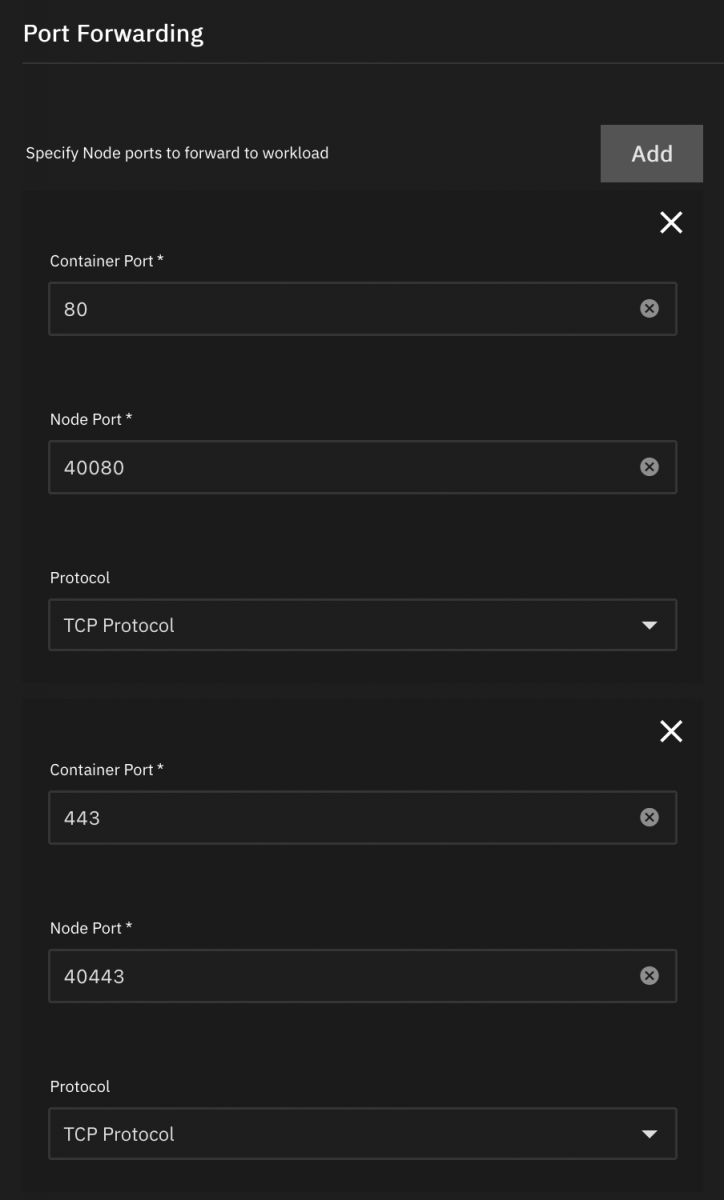

Under Port Forwarding, add at least one to forward the container port 80 to something above 9000 (I chose 40080), do the same for port 443 if you want to publish https/TLS.
Under Storage, add a host path and point it at your chosen host path, mounting it to /usr/share/nginx/html:

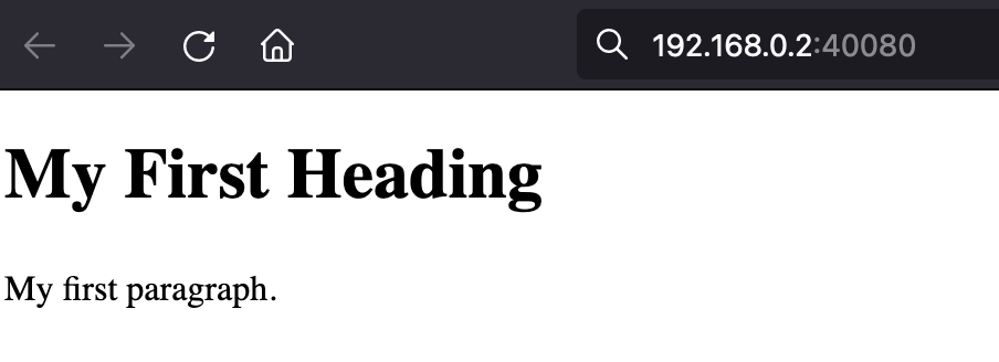

Save the app and visit your TrueNAS IP at port 40080 http://192.168.0.2:40080/ to view the contents of your host path.
Amazing it works thank you so much for your help you are amazing!
