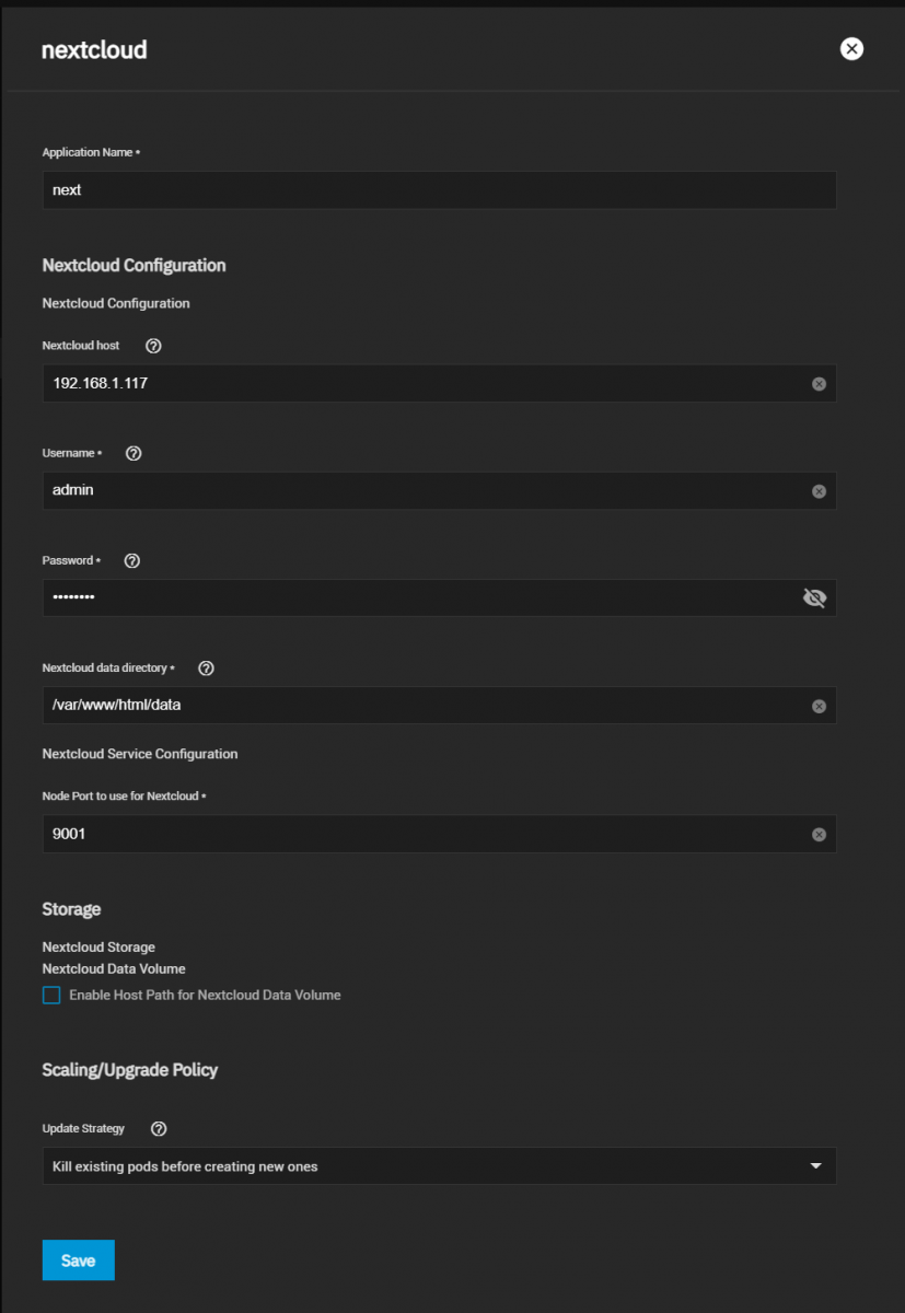

lets get to it, I start from scratch with a new install and try to be as luser as possible.
Application Name * --> those problems with capital letters, I ve posted in jira
Version * --> nothing to change here (why is there even a dropdown box?)
Nextcloud host either 0.0.0.0 works as an asterisk or an actual working ip should be put here, I had trouble for the first two setups to realize this problem.
Username * --
Password * --
Nextcloud data directory * --> a CLEAR description or a different name should be chosen: what am I defining here?
Node Port to use for Nextcloud * --> should maybe marked/be hidden as an "advanced" option? newbs and lusers dont need this :P
Nextcloud Data Volume [ ] Enable Host Path for Nextcloud Data Volume --> mostly mixed up with Nextcloud data directory ... those two need better differentiation!! by name, by always visible description, many people fail here from what I see in youtube videos and from reading comments, just calling it not working.
what is needed here: being able to use EVERY present dataset
what would be even better: being able to add more then one directory which than show up inside of Nextcloud, in my case LIVE data and ARCHIVE data folders. access then can be managed inside of Nextcloud.
I dont know if it is possible, but if the SCALE home folder for the users could also be the home folder of the Nextcloud users, would be PERFECT, so no matter how I connect to the NAS, I always start/end up in the same folder/location. That would be a clean result and what is what I would like to have and try to achieve.
Update Strategy - Kill existing pods before creating new ones --> a small description whats going on here would be nice for newbs/lusers, or just again, maybe hide it under an advanced spoiler?
Because k8s doesn't accept names with capitals everywhere to begin with. With at TrueCharts don't support it either.
These are not container versions, but the version of the App itself. A dropdown is the cleanest solution, as there are a limited number of versions available anyway.
I'm not sure how I would implement this differently for TrueCharts tbh. As i'm not sure the UI has the feature to fetch some of this info as of yet, though I did discuss this before with iX devs and it is within their view. But the to-do list is quite long
Click little questionmark behind it ;-)
That being said, it's not clear that this is a path inside the container and i'm also not sure WHY FFS this should be changable by the user anyway. Just default by place it outside of the nextcloud config folder and have an option for the user to select a path on the host system instead.
Uhmm, I don't find "pick you own port" an advanced feature.
With TrueCharts we even offer multiple different kinds of services (ClusterIP, NodePort and Loadbalancer), so this will not be simplified for the TrueCharts version.
No, the devs should nuke that whole data directory thing, give it a sane default and it's own hostPath option. It shouldn't mater where in the container the data is stored for the end-user. (see above)
Yes, this has been something i've been reworking on TrueCharts as well.
How I designed it is:
- 2 differnet storage systems: One managed by TrueNAS (based on PVC). One to add additional mountpoints for all data the user wants to mount from host to container (docker style)
You don't mount datasets, you mount hostPaths. Thats not even limited to datasets to begin with. However: It is limited to /mnt.
Why? Because hostpath mounts have SEVERE security implications within k8s, with a little bit of bad luck you can excape the container using them.
A bit like how TrueCharts already gives an " unlimited storage" option I think?
This is already possible. You just need to select your nextcloud home folder when creating the user.
With something like TrueCharts our unlimited mountpoints one could also ofc create unlimited mounts to userfolders too.
Sorry, but it's still k8s. At TrueCharts we experimented with abstracting more things aware from the user and it only lead to more confusion form users in the long run.
For TrueCharts we are even exposing MORE k8s native features. With the argument: "Don't know? Don't change!"

so, without a specific host path, everything works, scale even shows me the menus correctly and I could also re-add truecharts,
seems that scale just had a bad evening last time, without me doing anything, everything works now.
So having it running again, the main problem is to get my data accessible by and trough NextCloud.
As I said, the most perfect thing would be to have /mnt/ accessible in the first place,
the next step would be that NC uses the SCALE home folders for the individual users, so they always see the same folderstructure, no matter if they connect trough SMB or use NC
the next step would be a pre-setup solution for the user credentials. so all SCALE users and groups would be available inside of NC as well, just set/import your ACLs and off you go.
the ultimate dream would be: enabling NC, downloading the sync client, done (okay, we leave domains, dyn dns and networking in general aside at this point :P maybe there will be an easy and competitive solution for this as well, later on) users can connect to their homedir trough nextcloud, without anyone ever doing anything else but hitting the install button in the catalog overview. if some one needs more specifics, they could still set it up, as they like. but the "all in one working out of the box" solution would be the optimum for lusers and beginners, who just need a minimal setup working, without any hacking and configuration to do.
So, that was, what I understood as my part @ornias , did I get it correctly, or did you expect something else, please tell me :)

@derWalter Currently, as explained on discord, we're working on actually getting SCALE working again after it was broken last week.
