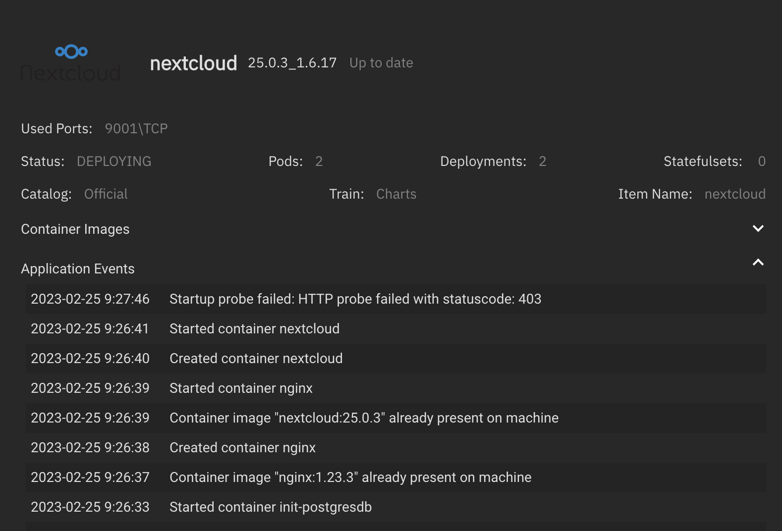

I have the same issue with the cronjob. I disabled it for now to get something working after the latest truenas update...
But then I'm stuck with the HTTP probe error that doesn't let the app finish the deployment. I don't know what I'm missing here, but I already spent a lot of hours last night getting my Nextcloud back to work after the tn update
