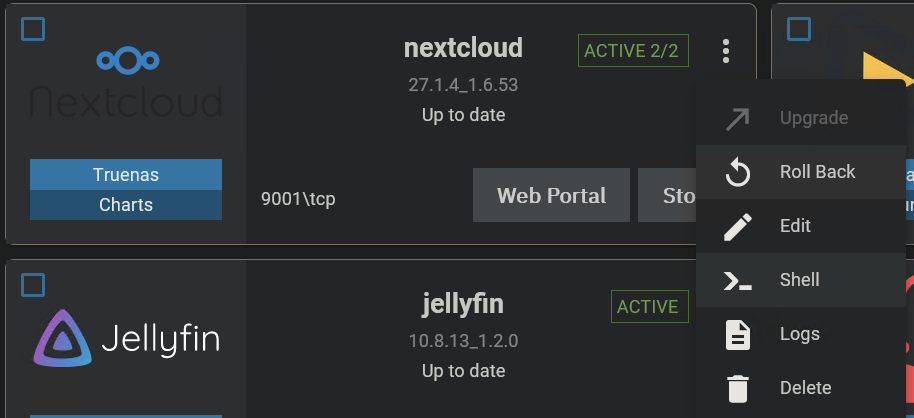

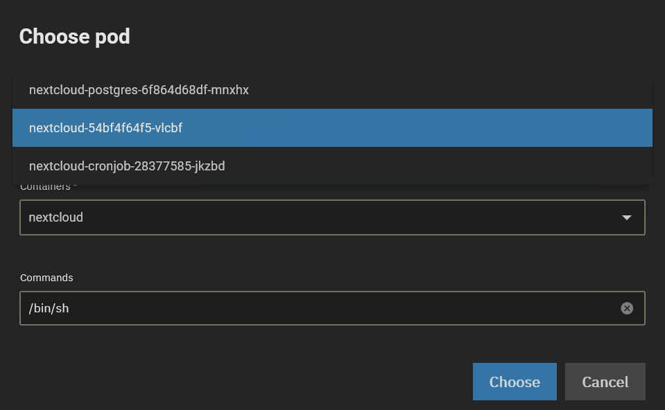

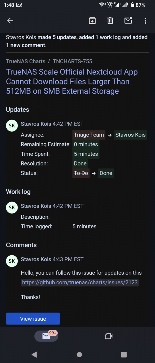

I've checked the "install smbclient" checkbox for the app and was able to mount SMB shares as external storage. However, Downloading large files from the SMB external storage stops at 512MB. I found this issue on Nextcloud Github suggests libsmbclient-dev should be installed. Therefore, I referenced official example and ran the following inside the Nextcloud container:
Problem solved........for now.
Obviously it is not persistent after restarting the container.
