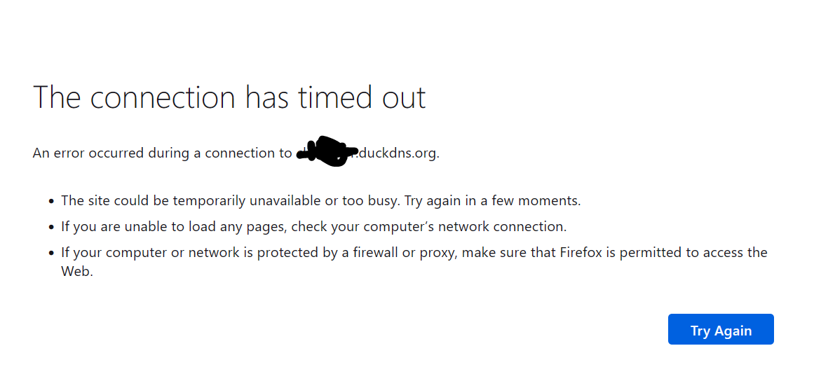

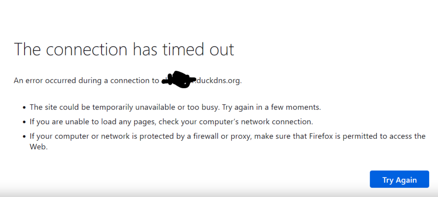

so i completely removed the jail ... and executed the command from the scratch .. but still cant access it :(
and i am using duckdns.org instead of Cloudflare...

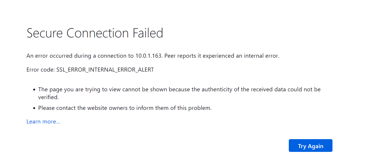

and when i try access it from local ip it says >

Look at my earlier post again--I said NEXTCLOUD_VERSION="24". Just specify the major version; the script automatically downloads the latest minor release in that.
yes fixed but still cant access it :(

There's a support thread for that script, and it's linked in the GitHub repo. This isn't it. There's also pretty thorough documentation. I'm happy to address deficiencies if they're identified, but a drive-by line like this makes you look like a smart*ss, and doesn't do much to motivate me to help you. One of the things that documentation says is that you shouldn't expect access via IP address to work. Another of the things it says is that your hostname needs to resolve to the local IP of your jail from inside your network. I'd expect one or the other, or both, of these is responsible for the issues you're seeing.
yes thats correct and it doesnt work.
