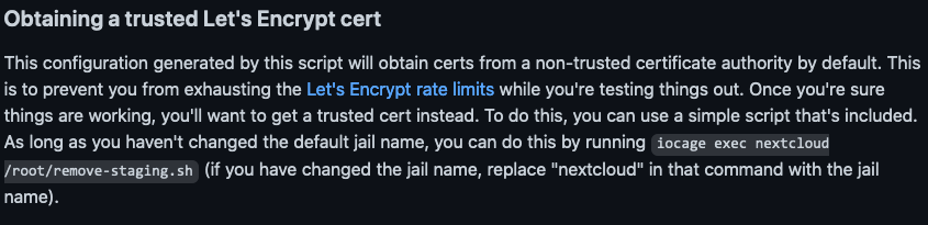

No, that doesn't look like it's from the staging environment. For context, by default, my script configures Caddy to obtain certs from the Let's Encrypt staging environment, in order to avoid exceeding the rate limits--but those certs wouldn't be trusted by your browser. Once your environment is stable and everything's otherwise working, I have a small script to change you to using the production environment. From the README:
But when you do that, the staging cert will expire, and you'll get a few warning emails about that. So that was my first guess--but I'm pretty sure the text would indicate that.
