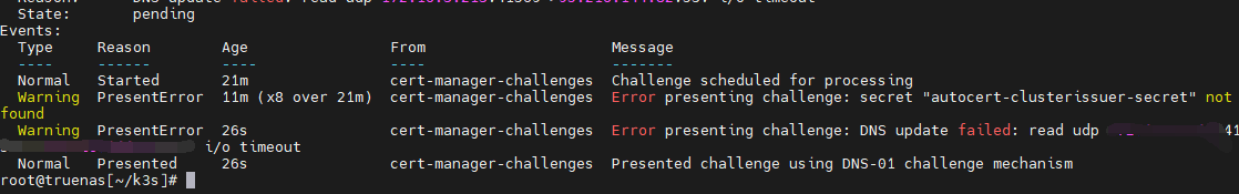

The application events included the following:
Error presenting challenge: error getting cloudflare secret: secret "<name>-clusterissuer-secret" not found
This event only appeared once. It does not appear again if I change an app setting and redeploy it.

I got the same error. So I try to google it and I found this https://github.com/cert-manager/cert-manager/issues/650.
I export the Secret from the namespace "ix-<app name of clusterissuer>"
k3s kubectl get secret autocert-clusterissuer-secret -n ix-cert-manager -o yaml > autocert-clusterissuer-secret.yaml
Then remove the namespace inside the yaml and import into both namepace "kube-system" and "cert-manager"
#namespace cert-manager is created by the Cert-Mananger  in operators train.
k3s kubectl apply -f autocert-clusterissuer-secret.yaml -n cert-manager
k3s kubectl apply -f autocert-clusterissuer-secret.yaml -n kube-system
After that, it's all good.
