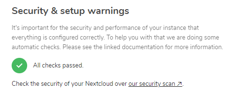

Hey! I've made a little guide based on yours. I needed to also fix:
"PHP does not seem to be setup properly to query system environment variables. The test with getenv(“PATH”) only returns an empty response.
Please check the installation documentation for php configuration notes and the php configuration of your server, especially when using php-fpm. "
& Enabling MySQL 4-byte support
1. Install Nextcloud via FreeNAS Plugins
Keep note of the database login info inside of the installation confirmation dialog
2. Shutdown Jail and add a Mount Point (It's always a good idea to place your Nextcloud data outside of the webroot)
Source = "/mnt/FreeNAS/Nextcloud"
Destination ="/mnt/FreeNAS/iocage/jails/nextcloud/root/mnt"
3. Start up your jail and navigate to your Nextcloud installation. Update the data field to "/mnt"
4. Back in shell run "ee /usr/local/etc/pkg/repos/FreeBSD.conf"
change "FreeBSD: { enabled: no }" -> "FreeBSD: { enabled: yes }"
5. Run "pkg install py27-certbot"
6. Run "certbot certonly" Follow prompts
webroot is "/usr/local/www/nextcloud"
7. Take note of:
"ssl_certificate "/usr/local/etc/letsencrypt/live/x.domain.com/fullchain.pem";
ssl_certificate_key "/usr/local/etc/letsencrypt/live/x.domain.com/privkey.pem";"
8. Run "ee /usr/local/etc/nginx/conf.d/nextcloud.conf" and update
"server {
listen 80;
listen [::]:80;
server_name cloud.jovaniedelacruz.me;
# enforce https
return 301 https://$server_name$request_uri;
server {
listen 443 ssl http2;
listen [::]:443 ssl http2;
server_name cloud.example.com;
ssl_certificate "/usr/local/etc/letsencrypt/live/cloud.jovaniedelacruz.me/fullchain.pem";
ssl_certificate_key "/usr/local/etc/letsencrypt/live/cloud.jovaniedelacruz.me/privkey.pem";
add_header Strict-Transport-Security "max-age=15768000; includeSubDomains; preload;";
9. run "ee /usr/local/www/nextcloud/config/config.php"
add your trusted domain as per entry 0.
10. run "ee /usr/local/etc/php-fpm.d/nextcloud.conf" and add to the bottom
"env[PATH] = /usr/local/bin:/usr/bin:/bin" then run
"service php-fpm restart"
11. run "mysql -u dbadmin -p"
run and check "show variables like 'innodb_file_per_table';" for ON value
If it's ON then run
"ALTER DATABASE nextcloud CHARACTER SET utf8mb4 COLLATE utf8mb4_general_ci;"
and "exit"
12. Should be good! Restart jail for good measaure.
Automatic Certificate Renewal [SEE COMMENT BELOW FOR BETTER IMPLEMENTATION]
Testing the renewal with a dry run: certbot renew --dry-run
SSH into your FreeNAS and run the command "jls" this will show you the JID (Jail ID), in my case it was ID=8
Go to the FreeNAS WebGUI and add a monthly cron job as root that renews the certificate and restarts nginx
jexec 8 certbot renew --quiet --rsa-key-size 4096 && jexec 8 service nginx reload
+ Thanks danb35!
Doing all this yields me a "All checks passed" and an A+ security rating!
