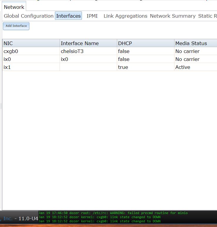

I rumaged around and came up with an old single port Chelsio T310 card that was installed without
a transceiver in the SPF+ port and shows no errors.
Jan 19 17:46:44 dozer ix0: <Intel(R) PRO/10GbE PCI-Express Network Driver, Version - 3.1.13-k> port 0xd020-0xd03f mem 0xdfd80000-0xdfdfffff,0xdfe04000-0xdfe07fff irq 16 at device 0.0 on pci3
Jan 19 17:46:44 dozer ix0: Using MSIX interrupts with 3 vectors
Jan 19 17:46:44 dozer ix0: Ethernet address: 00:1b:21:99:ce:e8
Jan 19 17:46:44 dozer ix0: PCI Express Bus: Speed 5.0GT/s Width x4
Jan 19 17:46:44 dozer ix1: <Intel(R) PRO/10GbE PCI-Express Network Driver, Version - 3.1.13-k> port 0xd000-0xd01f mem 0xdfd00000-0xdfd7ffff,0xdfe00000-0xdfe03fff irq 17 at device 0.1 on pci3
Jan 19 17:46:44 dozer ix1: Using MSIX interrupts with 3 vectors
Jan 19 17:46:44 dozer ix1: Ethernet address: 00:1b:21:99:ce:e9
Jan 19 17:46:44 dozer ix1: PCI Express Bus: Speed 5.0GT/s Width x4
Jan 19 17:46:44 dozer cxgbc0: <Chelsio T310, 1 port> mem 0xdf081000-0xdf081fff,0xde800000-0xdeffffff,0xdf080000-0xdf080fff irq 16 at device 0.0 on pci4
Jan 19 17:46:44 dozer cxgbc0: PCIe x4 Link, expect reduced performance
Jan 19 17:46:44 dozer cxgbc0: using MSI-X interrupts (3 vectors)
Jan 19 17:46:44 dozer kernel: found newer FW version(7.12), driver compiled for version 7.11
Jan 19 17:46:44 dozer cxgb0: <Port 0 10GBASE-R> on cxgbc0
Jan 19 17:46:44 dozer cxgb0: Using defaults for TSO: 65518/35/2048
Jan 19 17:46:44 dozer cxgb0: Ethernet address: 00:07:43:06:08:c2
Jan 19 17:46:44 dozer cxgbc0: Firmware Version 7.12.0

Adding the card to the FreeNAS network configuration just lists it as no carrier.

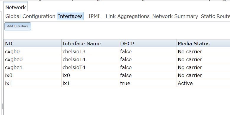

I added another card, this one a Chelsio T4 dual port, no transceivers, no issues.
