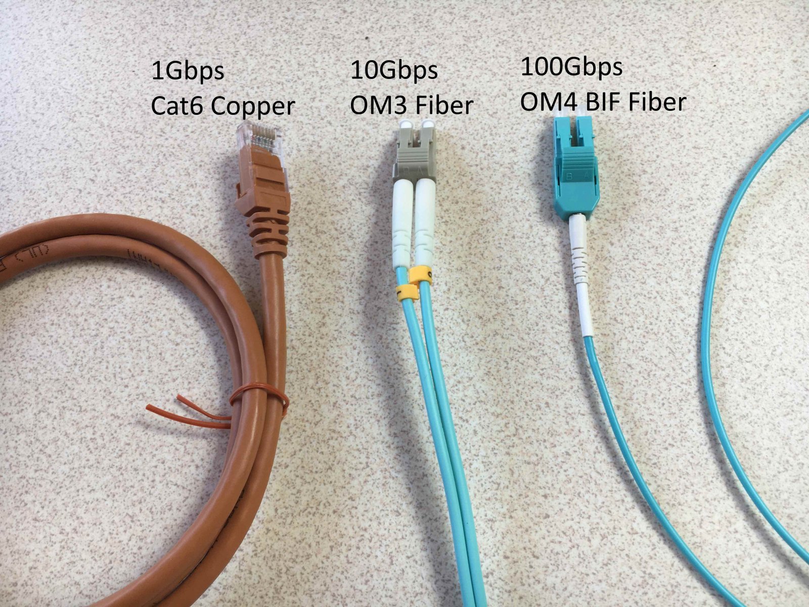

https://extranet.www.sol.net/files/misc/biffiber.jpg
Lately I've been installing OM4 BIF fiber patch, which is capable of up to 100Gbps and is as thin as a strand of dry spaghetti. But the shocking thing is that normal rack-length OM4 patch cables are less than ten bucks each.
I am probably repeating myself here, but I have been using fiber instead of DAC/Twinax cables for two reasons. Twinax cables are really hard to manage since they tend to be large and don't bend easily. The more important reason is that you can put transceivers in each side that the card/switch likes, and then there aren't any compatibility issues. I have had all kinds of peculiar issues with Twinax compatibility which is why I almost never use them now.
