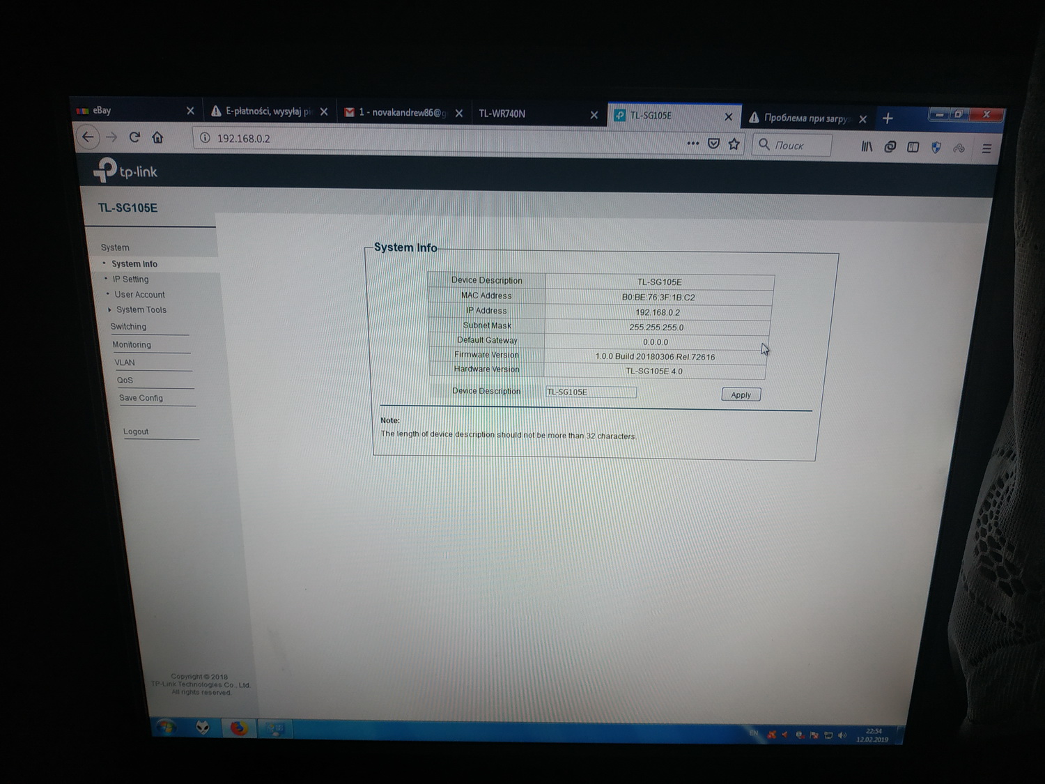

Right now I have internet on my pc, can access the switch and router GUI, but still can't access the NAS GUI, already reboot everything: nas, pc, switch, router...

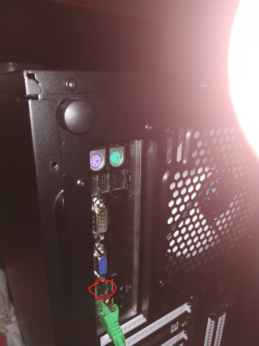

here it is

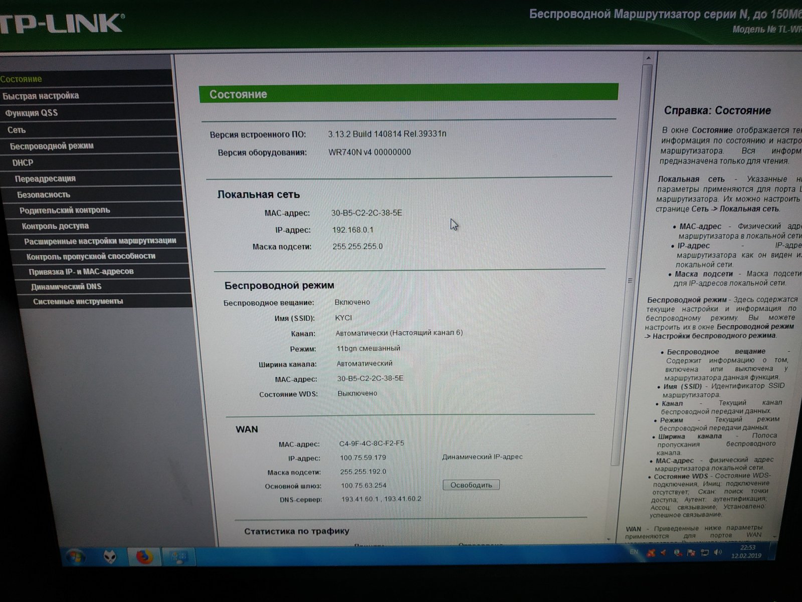

router and switch config attached

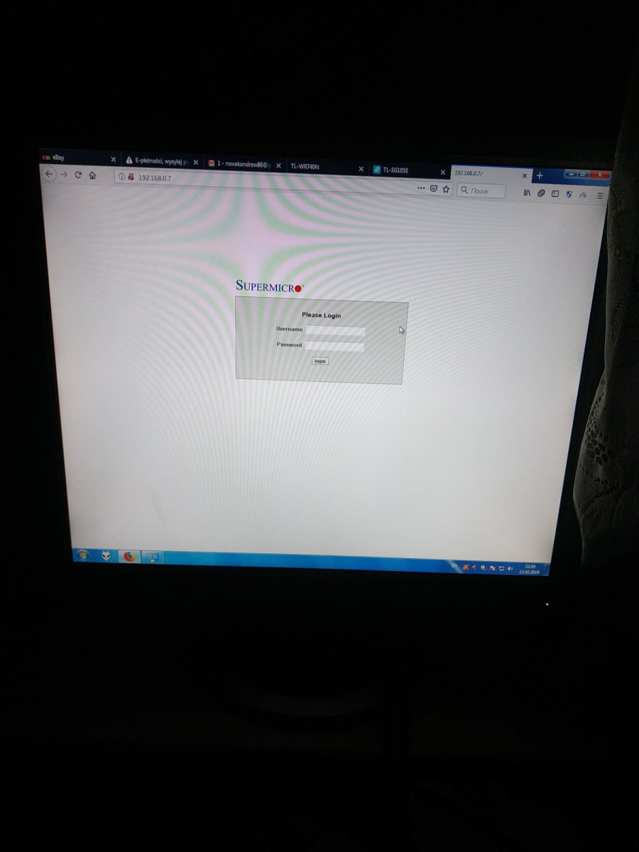

just switched to another port and right now I have this window:

that one is the ipmi inteface
Chris Moore
May 2, 2015
10,079
That is the IPMI management console. Did you install FreeNAS yet?

it's this port that I connected right now, img attached

The image you showed of the IPMI console shows the IP address that you said you configured for FreeNAS. They can't both have the same address. The IPMI interface works like a whole separate computer. Each one needs it's own address. That means you need to change one of them.
