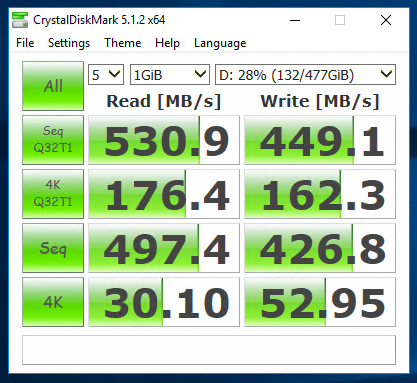

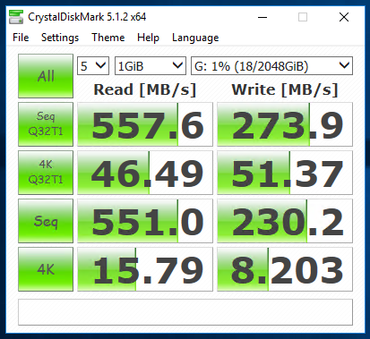

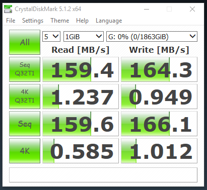

If that is all you want, there isn't anything especially wrong with it. It just doesn't have much to offer. In just a few years, I imagine that all networking will be 10Gb. It is kind of how networking went from 10 to 100 to 1000 over the course of a just a few years, but it took a while before people had a desire to go faster than 1000 (1Gb) because the storage wasn't fast enough to keep up. Now that storage is starting to get there, it can actually be a nice thing to have a faster network. Here is an illustration to help.
This is the speed of a locally connected hard drive in my workstation.
