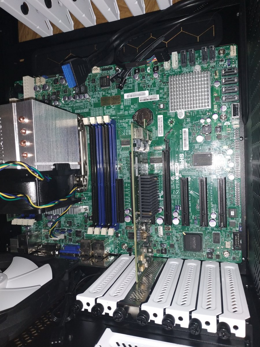

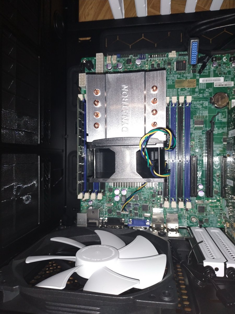

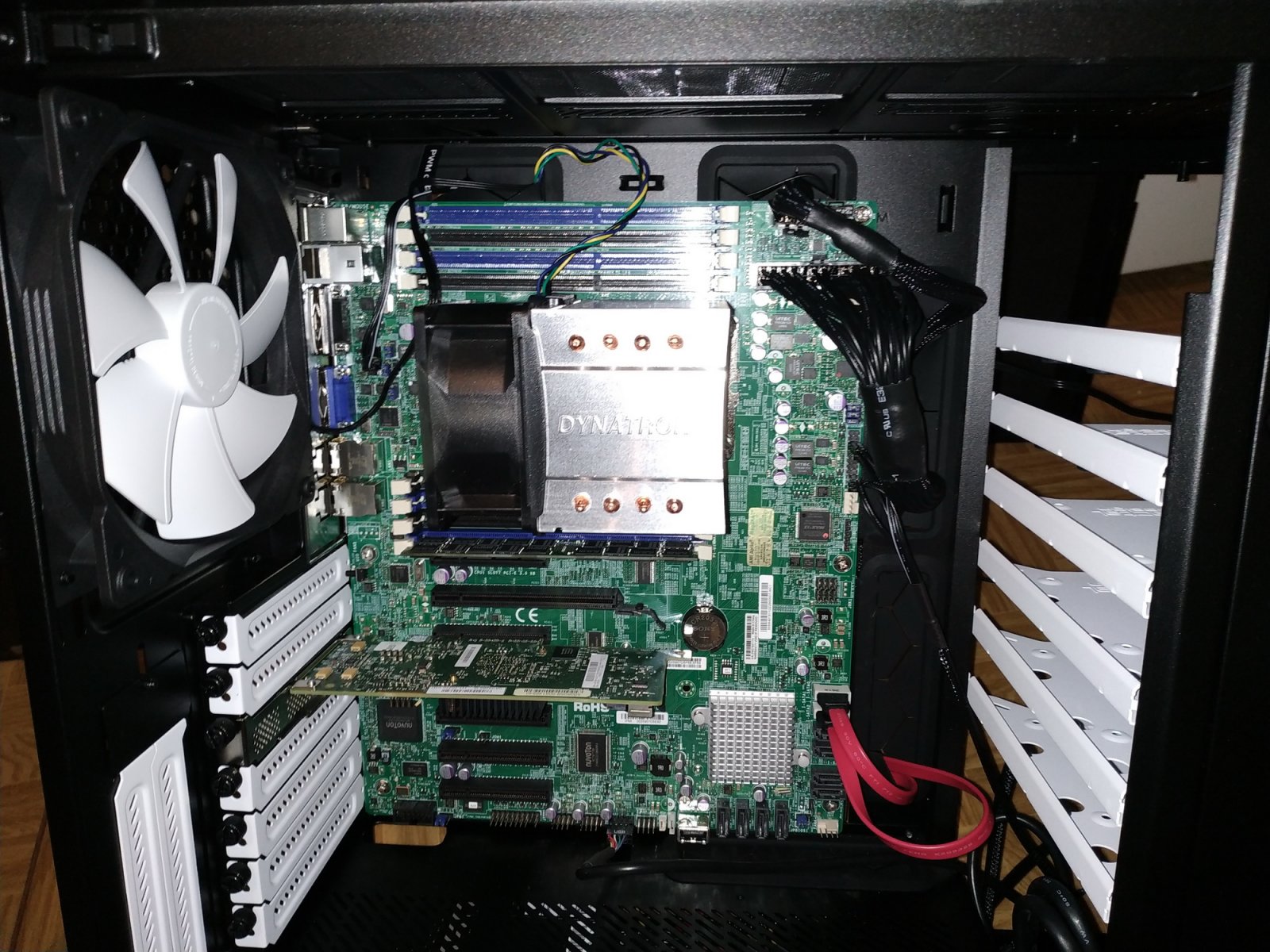

Hi Chris, just got all the hardware for my NAS except HDD's:)
I have a couple of questions:
1) I bought only one RAM 16 GB right now and put it in the first slot (see attached pics), is this the right slot to put it?
2) Also I put sas controller on the motherboard (also on the attached pics), did I put it in the right slot? Also on the sas controller there is 4 pin connector, do I need to connect it to power or just leave it(sorry for the noob questions:)
3) Also 3 coolers in the case are 3 pin, and on motherboard is only 4 pin connectors, I read that I can connect this 3 pins to 4 pin on the motherboard, but the coolers would be running 24/7, how can I fix it?
4) The case have 2 USB 3.0, but the mother board have only USB 2.0 ports, maybe there is some kind of converter from sata to USB 3.0?
5) Power supply have only 2 cables with 3 power sata connectors and 1 cable with 3 old ata power connectors. As far as I see I need 9 sata power connectors(6 hdds+2 ssd's+ 1 power for the case). So I need to buy another cable with 3 power sata connectors? Please advice. and thanks for your help:)

Chris Moore
May 2, 2015
10,079
If you have a look at the quick reference, it only shows configurations with memory modules in pairs.
The full manual indicates that using pairs of modules is recommended because it, "will result in interleaved memory, which will improve memory performance."
It should work with just one module, and DIMM1A is the slot you should use first.
The quick reference guide:
https://www.supermicro.com/QuickRefs/motherboard/C606_602/QRG-1317.pdf
The full system board manual:
https://www.supermicro.com/manuals/motherboard/C606_602/MNL-1317.pdf
You have options and this is fine.
No. The SAS controller gets power from the system board through the card edge connector. The cards I have experience with have two of the 4 pin headers and one is for connecting drive activity LEDs and the other is for serial data but you don't need to do anything with those.
The fans should run all the time to keep the hard drives cool, but it looks like you have the CPU cooler installed backward.
You can probably pickup an adapter to connect the USB 3.0 ports to a USB 2.0 header, but there is no real need for USB.
https://www.ebay.com/itm/USB-3-0-20...9-pin-Female-Adapter-Short-Cable/332463592592

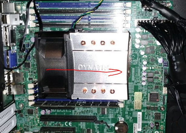

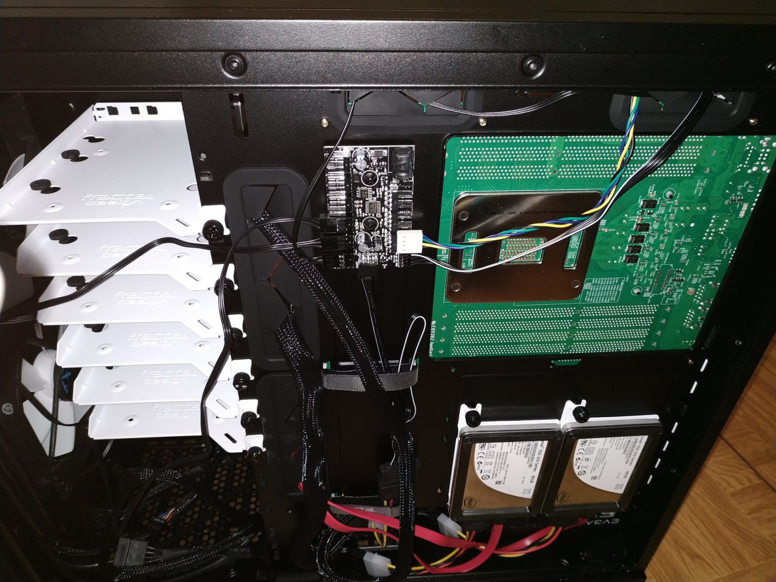

Also just finished the power management, can you please look at the pics, thank you:)

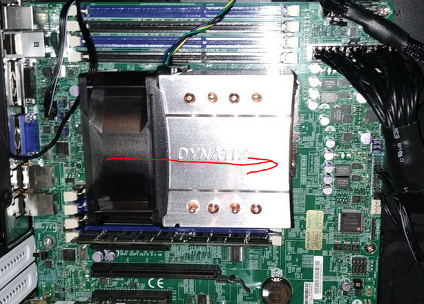

Chris Moore
May 2, 2015
10,079
On the CPU cooler, the normal airflow is in the direction of the arrow I drew in there, so it looks like the whole assembly is mounted backward.
However, it is possible for the fan to be flipped around to blow the other direction, and from this distance, it is difficult for me to tell with certainty.
Like I said, it absolutely can be mounted either way around, and the fan can be flipped, so I am only suggesting that you double check this.
When I get home tonight I can get a photo of how I have my CPU cooler installed.
670739
Dec 13, 2018
53
I put it this way because the title "Dynatron", if I put it the other way, the title would be upside down, and it was strange to me:)
Chris Moore
May 2, 2015
10,079
I get that, but they were not putting that on there to show orientation because these are normally mounted in a server where very few people will ever see it and many servers are mounted horizontally instead of vertically.
The regular airflow direction and fan position also helps to keep the VRM modules cool. They are directly behind the processor.
pro lamer
Feb 16, 2018
626
It might be worth mentioning: the regular airflow through the whole case is usually from front to back.
Edit: and mounting a CPU fan against that direction may disturb airflow and worsen cooling effect.
Sent from my phone
670739
Dec 13, 2018
53
I see, OK, so I'll unscrew whole unit (cooler and radiator) and put it the other way around. Thanks:)
