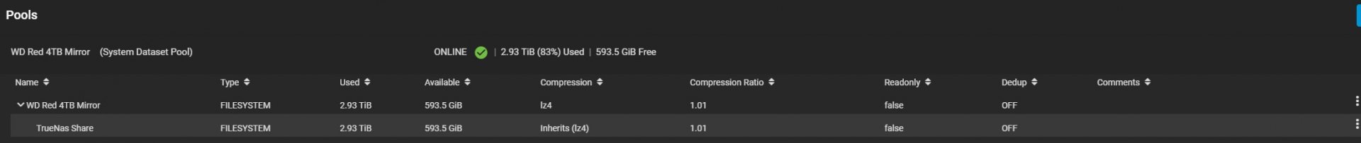

I am running the latest version of TrueNas core on an old server with 3 bays available for data storage. Currently I have 2 of these bays occupied with 2x4TB WD Red Drives setup in a mirror configuration with the 3rd bay in the server empty.
I have already used up 80% of my HD space in the above configuration and am looking to upgrade my available storage space by adding a HD to the currently empty 3rd HD bay in my server--my two options are (1) another 4TB WD red drive or (2) 12tb shucked WD white label drive as I already own these and want to avoid sinking more $$ into this endeavor.
